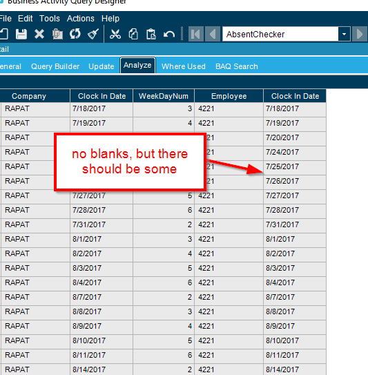

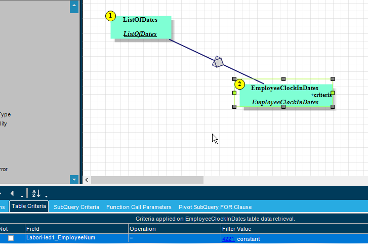

So I need a left outer join, because I am looking for where something isn’t. One thing that I have noticed is that if I put a criteria on the right table, it treats it like an inner join. Is this a SQL thing? Or an Epicor thing? Is this just the way it’s supposed to work? In this case I can get around it by putting the criteria in the sub query, but I won’t be able to always do that.

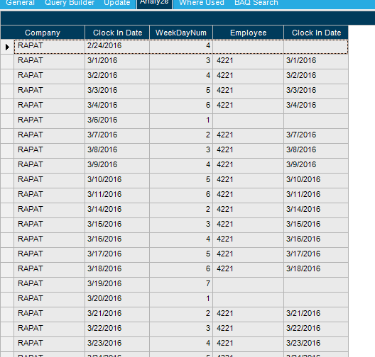

This is what it looks like if I use a sub query criteria or a criteria on the table in the sub query
Can you paste your code please.
Interesting twist, I started messing with stuff, and now all of the sudden it’s working as expected. I don’t know what I did to make it work… I was just trying to get it back to the way it was to grab the code for you.
