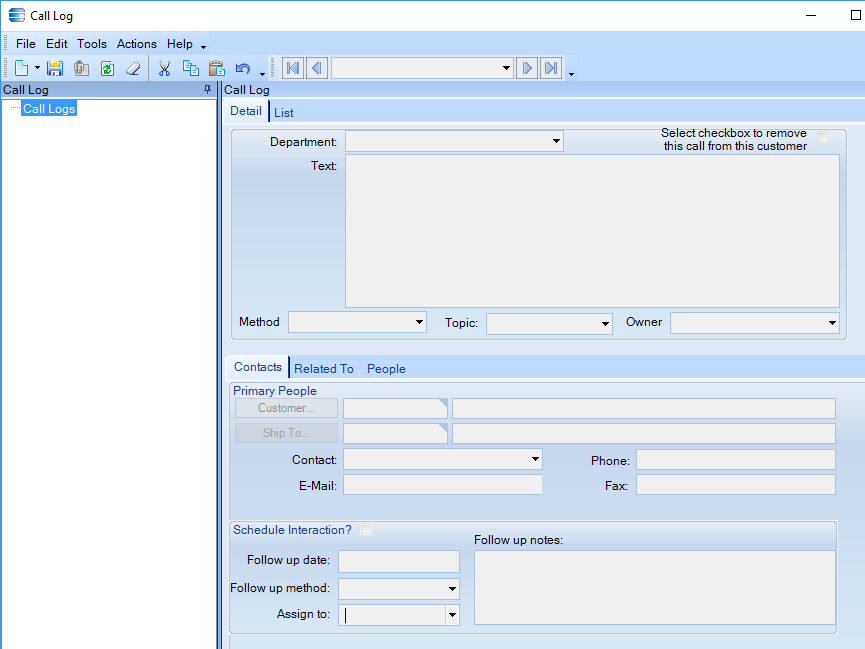

The first thing we did was add a bit of customization to our Call Entry screen - so that we could better refer to them in other programs and dashboards. Here we add the functionality for follow-ups:

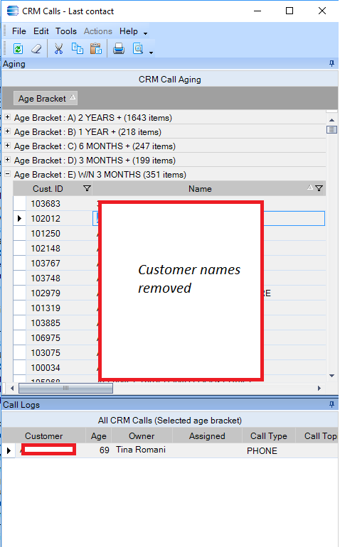

Then⌠Once weâve sufficiently populated the UD fields with calls, we created a dashboard for managing them:
Our sales team (and mgmt) can see who hasnât been contacted in a while and schedule calls accordingly.

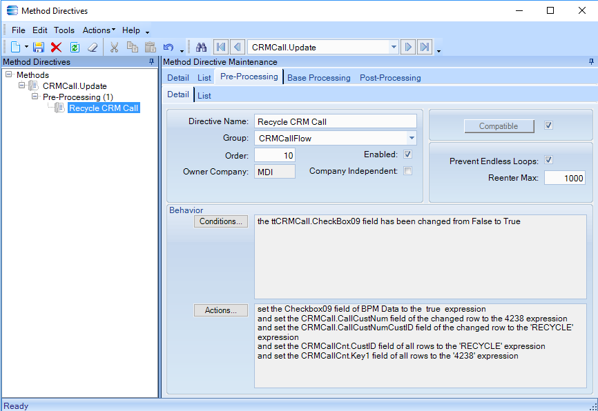

The checkbox labeled "âSelect checkbox to remove this call from this customerâ⌠Does that delete the CRM Call or just a BPM to changed some value on the record?
Through the front-end, a user cannot delete a CRM Call (for some no good reason).
Good catch Thomas. We added a BPM that inspects that box on a âSaveâ and, if checked, re-associates the call with a dummy customer weâve created for storing these items that canât be deleted.
Andrew.
If not too much trouble, do you recall if you re-assign âKey1â field or âCallCustNumâ (or Both)?
BTW, this was Epicorâs response to not being able to delete a CRM Call:
âThe development team reviewed this behavior. An enhancement has been created under SCR 163005 will change this functionality on a future version, in the meantime an option would be to either create a personalization, customization or BPMâ
Interesting Tom. When we went live, our response from Epicor was âwhy would you ever want to do that?â.
Hereâs my BPM:
I have to be honest and state that I do not know how often (or if) this is used. When we went live, the Sales department needed this functionality and it was tested to work - 2+ years ago. Nothingâs changed, so I assume itâs still working.
