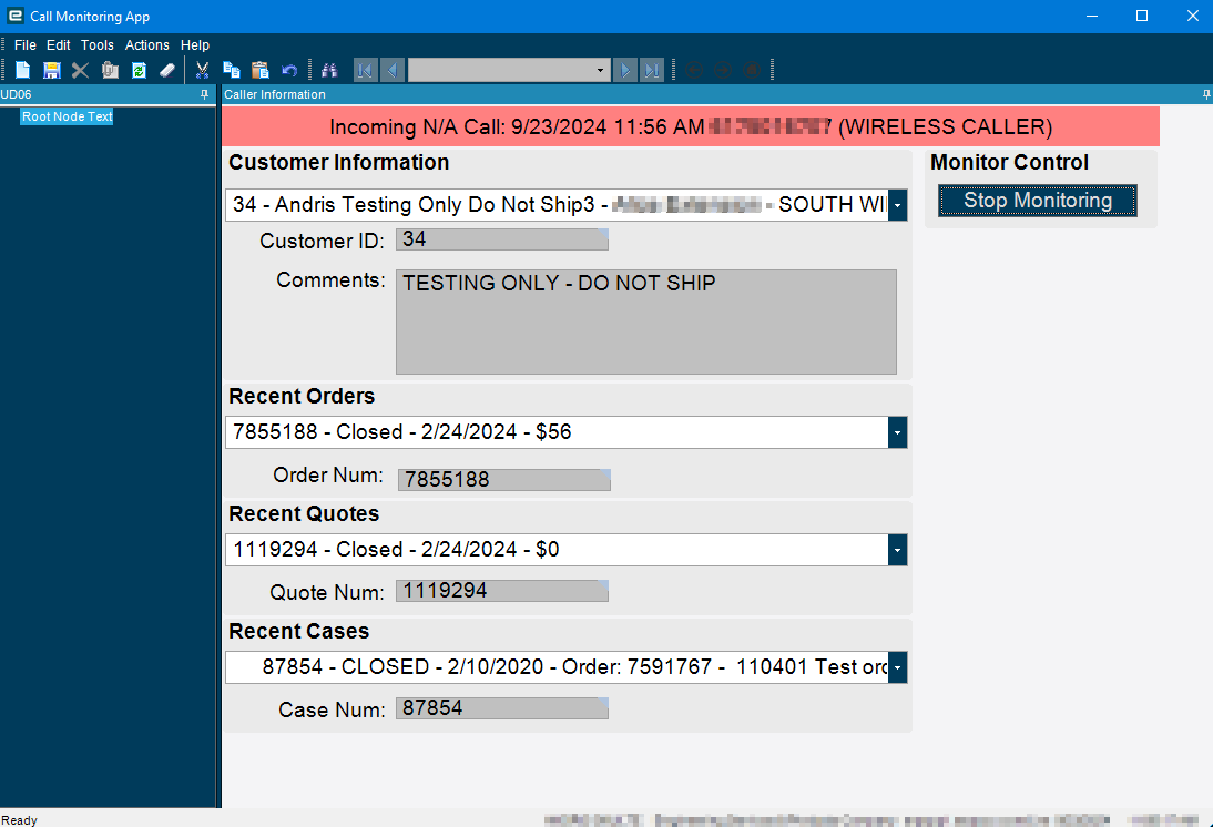

Evan,
Our talented developer created our own Call Monitor that does exactly that. Mitel VOIP phone system and 2023.2 running classic screens. We’re upgrading to RingCentral now, and slowly switching to Kinetic screens…
