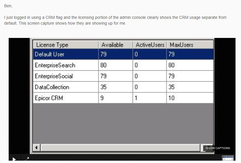

However, someone from the EUG shows me the opposite:
Are the CRM-Only licenses discreet from the standard client licenses?

This is telling me that the “?LicenseType” will define the license utilized. This info contradicts the info given from my CAM.
Ben
Our sales people all use the CRM license type. We edit the target line in the icon properties with the /CRM at the end. C:\Epicor\ERP10.2Client\Client\Epicor.exe /config=Epicor102.sysconfig /CRM. When Epicor is started using this icon it will always use the CRM license. Have been using it for 3 years and works very well for us.
