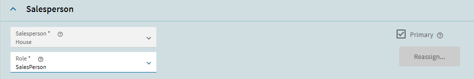

The system uses the Territory Salespersons to assign the roles. You can add multiple people and assign them different roles. If you do that, then the tasks will get assigned to the people and roles defined in the territory.

Yes. When you use Territory and a salesperson leaves, there is a process to run to update all open tasks to the new person.

could you say where i can update the person linked to task? . I am looking for it since this morning and i dont remember where …
I’m not sure if there is a process that will allow you to update open tasks from X to Y. But the Sales Territory screen has a way to change the salesperson and I am 99% sure that part of the process is to reassign tasks.
