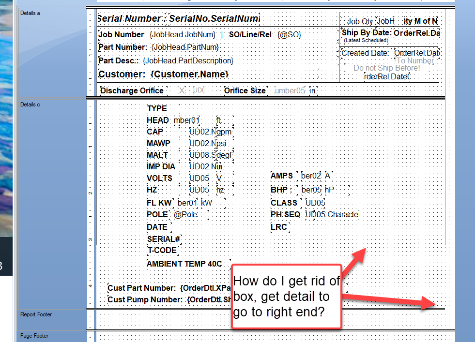

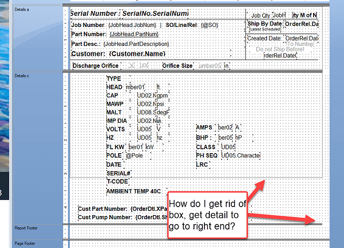

I have this crystal report that I cannot for this life of me figure out how to get rid of this area/limitation in it. It’s a box and it does not print and it makes the detail sections shorter. In section expert there is nothing making it happen. The text below the box (e.g., T Code, Ambient Temp) doesn’t show in preview/print. Any Crystal folks who can think of where this is stored/what it is?

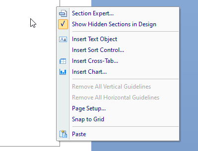

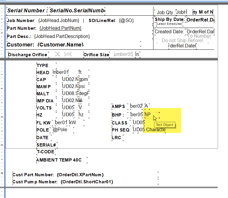

No, it does not. But the “hover/show me what it is” does work in general per screenshot below where it shows me that hp is a textbox. Also when in the space and I right click, it just shows me section expert stuff. It’s very odd. I’ve fooled around with it for at least an hour and just cannot figure out what I have going on. I tried lots of variation in page setup but that doesn’t make it go anywhere. Weirdest thing is that nothing under the box prints. No suppression of fields/text boxes.

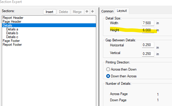

I think I see the what you need to do. The Details section has the Format With Multiple Columns checked and that’s what controls the ‘box’ size.

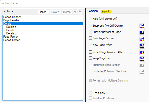

Open Section Expert
Click on Details and then Click on the Layout Tab
Change the Height to 6 and Crystal will resize the ‘box’. You may have to make it 5.75 or something more accurate.
Hi KP,
You’re a genius! I thought I had looked everywhere for something like this, but I guess I missed it. (And I make fun of my husband for his lack of looking carefully for things… :rofl:)
