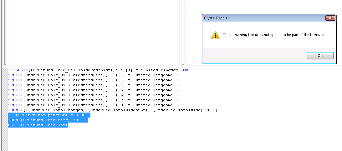

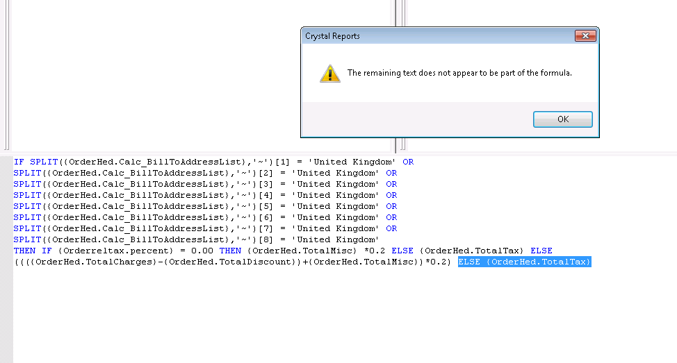

HI Guys, sorry im not the best at crystal syntax…do you mean like this Randy?
IF SPLIT({OrderHed.Calc_BillToAddressList},’~’)[1] = ‘United Kingdom’ OR
SPLIT({OrderHed.Calc_BillToAddressList},’~’)[2] = ‘United Kingdom’ OR
SPLIT({OrderHed.Calc_BillToAddressList},’~’)[3] = ‘United Kingdom’ OR
SPLIT({OrderHed.Calc_BillToAddressList},’~’)[4] = ‘United Kingdom’ OR
SPLIT({OrderHed.Calc_BillToAddressList},’~’)[5] = ‘United Kingdom’ OR
SPLIT({OrderHed.Calc_BillToAddressList},’~’)[6] = ‘United Kingdom’ OR
SPLIT({OrderHed.Calc_BillToAddressList},’~’)[7] = ‘United Kingdom’ OR
SPLIT({OrderHed.Calc_BillToAddressList},’~’)[8] = ‘United Kingdom’
THEN IF {Orderreltax.percent} = 0.00 THEN {OrderHed.TotalMisc} *0.2 ELSE {OrderHed.TotalTax} ELSE
((({OrderHed.TotalCharges}-{OrderHed.TotalDiscount})+{OrderHed.TotalMisc})*0.2) ELSE {OrderHed.TotalTax}
Yes that’s what I was meaning. Did it work for you? Though, I think Jim’s
suggestion is probably cleaner like you, if it works and doesn’t impact
performance too much I’d leave it alone.
i’ll try it now and let you know.
You only have two if’s so you can only have two else’s.
Try using a staggered format, like this:
IF…
THEN
__IF
__THEN
__ELSE
ELSE
You might have to use parentheses or something to get the order of operations right with this:
IF THEN (IF THEN ELSE) ELSE

i’ll give this one a go:
THEN ((({OrderHed.TotalCharges}-{OrderHed.TotalDiscount})+{OrderHed.TotalMisc})*0.2)
i tried it with parenthesis before the 2nd IF and at the end of the formula but still no joy
Remove “(((OrderHed.TotalCharges…” before the send IF statement.

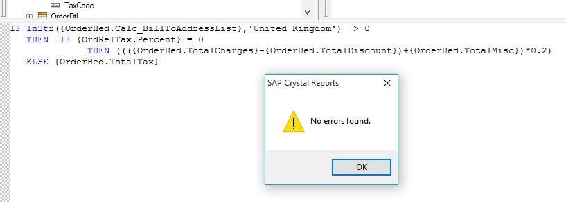

I was curious about the InStr function and ran this in CR. Also, you have OrderRelTax and my table has OrdRelTax
IF InStr({OrderHed.Calc_BillToAddressList},‘United Kingdom’) > 0
THEN IF {OrdRelTax.Percent} = 0
Hi Miguel,
Your formula returned no errors in the syntax but didn’t give the desired results…i’m just going to go back over the criteria needed as this thread has got quite large !
AND {OrderRelTax.Percent} = 0.00
THEN {OrderHed.TotalMisc} 0.2
ELSE ((({OrderHed.TotalCharges}-{OrderHed.TotalDiscount})+{OrderHed.TotalMisc})
{OrderRelTax.Percent})/100
The above seems to be working, i’ll do some thorough testing and report back…
