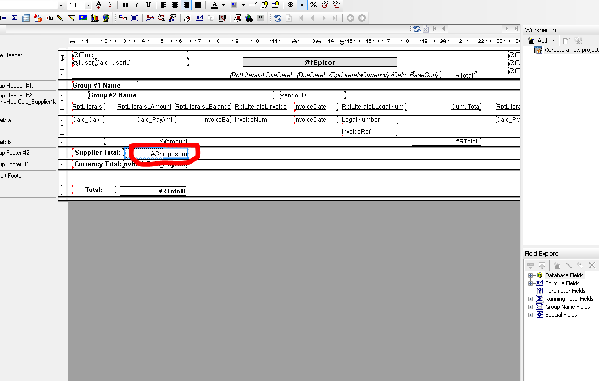

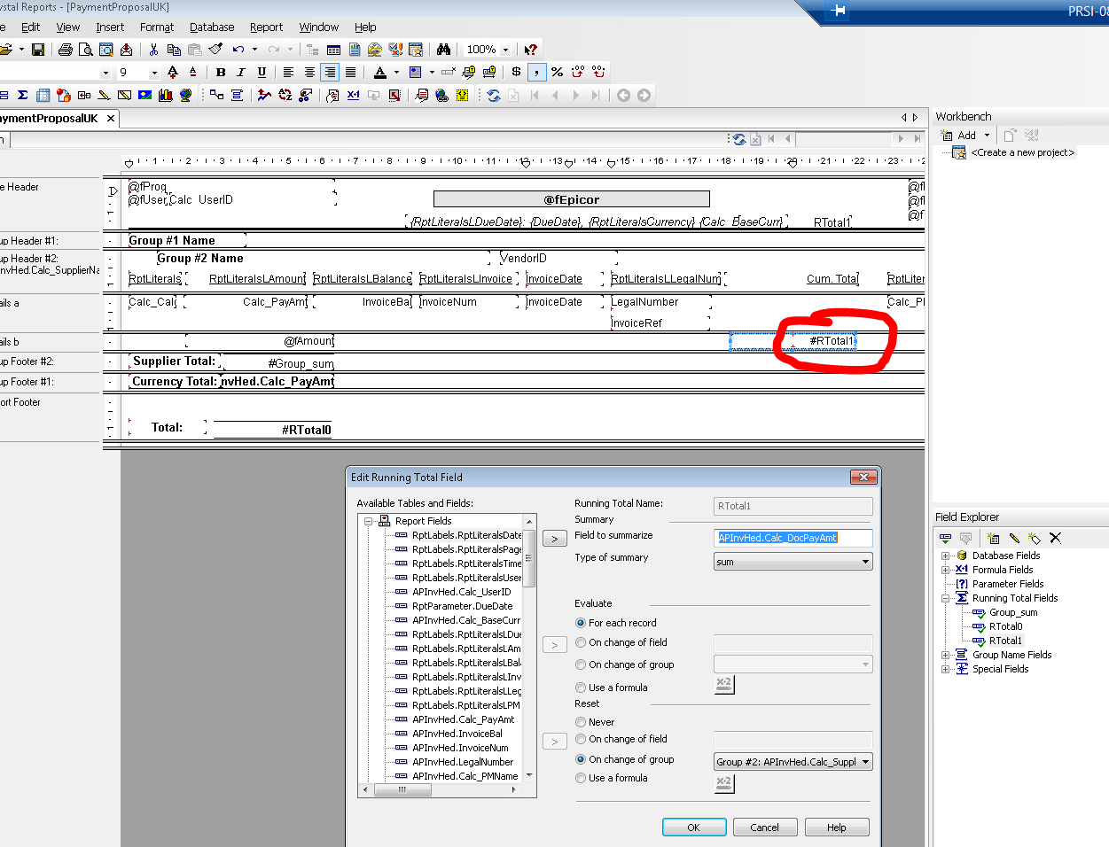

In Payment Proposal crystal report, i’m trying to only return records were the running total is greater than 0…(so no negative balances).
Normally to filter, i would right click on the field and select “select expert”, but this functionality doesn’t seem to work the same (probably because its not a database field but a running total field).
Any advice? thanks in advance.
I think you’re right in that the Running Total is not showing up as a selection option because the calculation for it happens as the report runs so it isn’t something you can filter records by. The only option I can think of for this situation would be a Suppression Formula and to suppress the Section or Group if the Running Total is less than or equal to 0.

i just tried this:
right clicked on highlighted field and selected select expert, picked the field “sum of APinvhed.calc_payamt”…and then sais is greater than 0.00
Given back to the user to test.
didn’t work…
I think you’ll need to use the famous “Three Calculated Fields” method.
  • The first initializes a global variable to 0. This is usually placed in a group header.
  • The second does the summing (adds the field value to global variable). In here is where you could put fancy logic; like stop adding if the running sum(the global var you’re using) goes negative
  • The last is used to display it. Not necessary if the value of the second is being displayed. But is used if you only want the end total for a group footer.
