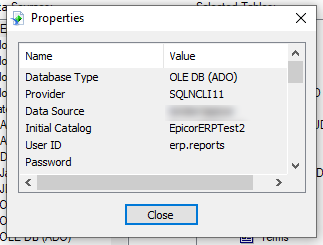

First attempt to get this working. Worked on it all day yesterday trying to get it to work. The E10 database is the source with the report being launched from the E10 menu. The report is being displayed with the default E10 Crystal Report viewer. The database source is just an ADO connection in the report. If you run the report outside of E10 with a Crystal Reports viewer it prompts for username/password. If I enter the same username/password that’s setup in the E10 Company Maintenance it runs fine.

@ckrusen - It’s an OLE DB (ADO) not a regular ADO.NET (XML).

What connection method are you using?
We are using ADO.

If you use the same username and password you used to make the connection in the crystal report are you getting the same error?
It just keeps prompting and never will run. We know the username/password is correct as it works in other Crystal Reports viewers.
Do you have the SQL Server Native Client installed on your client?
Looks like I do. As does another admin where the report works. Looking at a user workstation where the report doesn’t run. They don’t have it installed.
We had to install it on all client machines.
The SQL 2012 Native Client or the newer ( Microsoft OLE DB Driver for SQL Server) one?
