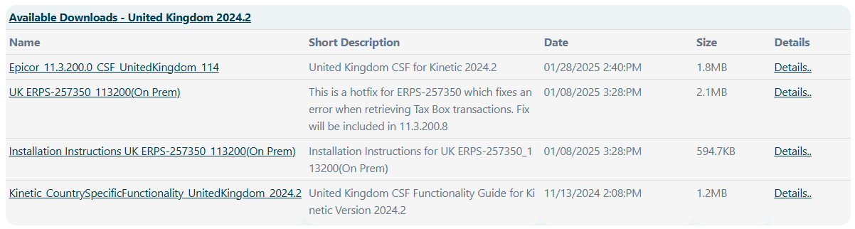

Is 151 for 2024.2? That is what we are looking to upgrade to and also have the UK CSF.

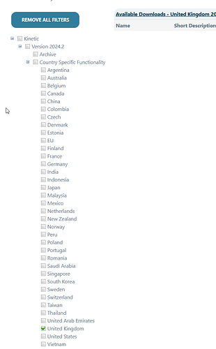

Also, cant find the latest version on EpicWeb
It should be here. Unfortunatley I don’t think I can see it because we are not licenced for UK CSF.

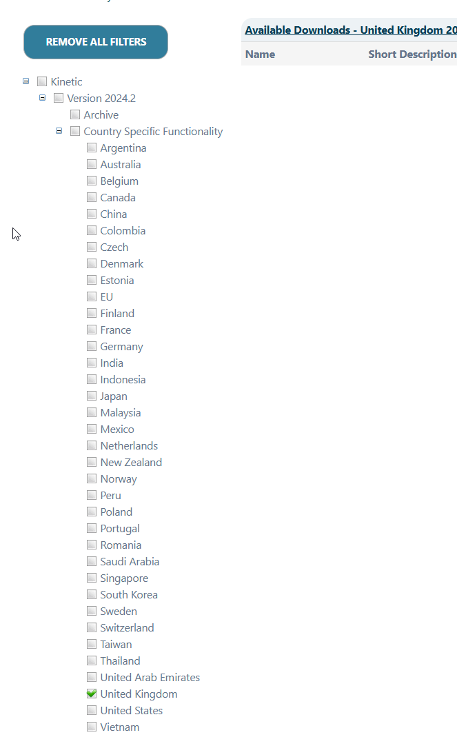

That is where we have been looking Simon and it is not there for us and we are licensed for it ![]()
Hmmm you might have to ask your CAM… Seems odd you can’t see it though…

We’ve had this happen before. It’s a website issue, and the best way I’ve found is to submit a ticket under Technical/Installation and it will get routed to the web team.
