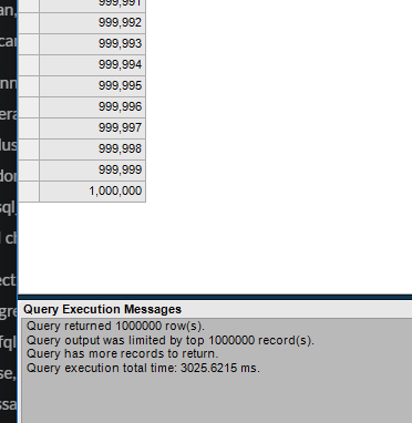

@klincecum s query…
Works too.
… and half the execution time, too.

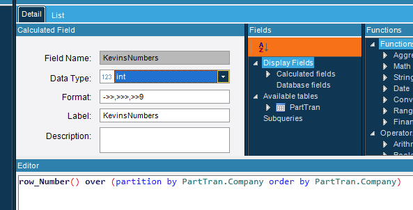

Btw @Banderson , what you showed is what I actually use when I want to get rows.
PartTran has plenty, and easy to grab. It may have even been you that gave me the idea.
