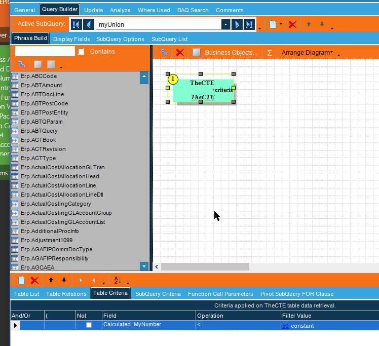

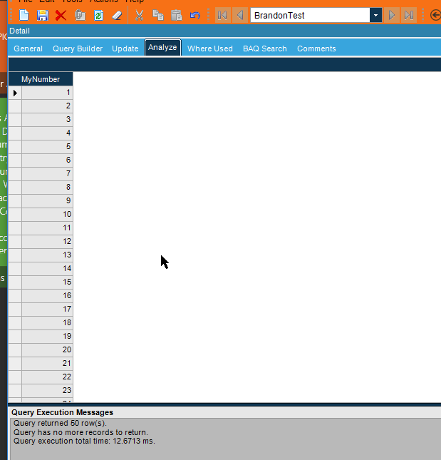

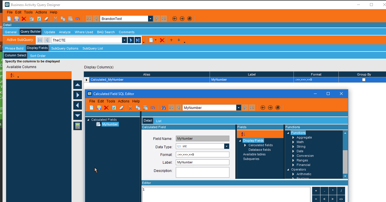

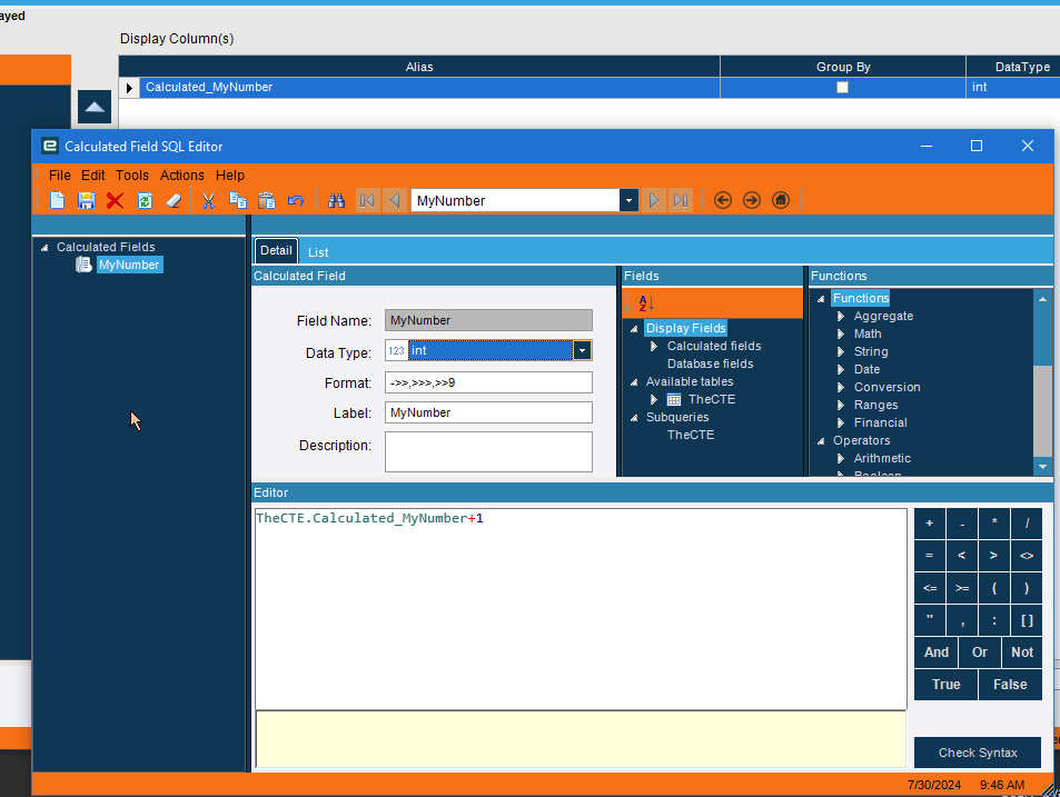

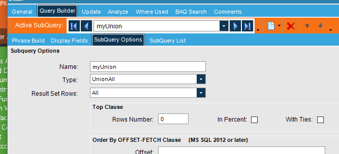

First, make a subquery that’s a CTE. Then a calculated field with your beginning number. (or a parameter if you need to to be different)
Then make a union all.
Add the CTE and put in the criteria for your end number.
Create a calculated field to take the CTE +1

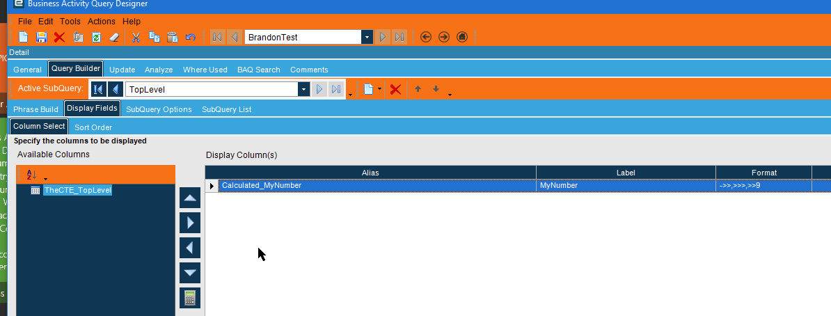

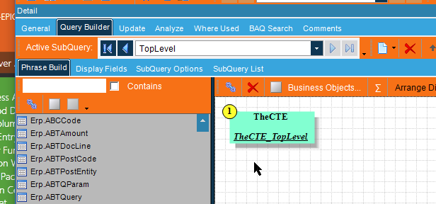

Then make a top level with the CTE in it.
Add the display field.

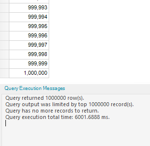

Recursion limitation isn’t the end of the world. It’s easy to CTE your way to arbitrary sequences!
with foo as(
	select
		null as whatever
	union all
	select
		null as whatever
), tally as)
	select
		row_number() over(order by foo.whatever) as increment
	from foo --< returns two rows
	join foo as a on 1=1 --< cross joins two rows: 2 * 2 = 4 rows
	join foo as b on 1=1 --< 8 rows
	join foo as c on 1=1 --< 16 rows
	join foo as d on 1=1 --< 32 rows
	-- see where this is going?
That’s how you get to arbitrary iteration in SQL, without recursion. It’s as performant as you’re going to get on SaaS. If you’re self hosted, this is how you can populate a tally table (literally, create table tally(increment int primary key);) that SQL Server will cache in memory for best possible performance.
