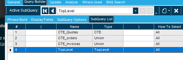

So I found the example, and made the query in the instructions, and like I suspected, was able to change the order, and add some () in the subquery list and it works the same with just unions. Same results. It’s maybe a little easier with the CTE , and the SQL is definitely easier to read. But as far as the editor goes, not required.
CTE:
Inner sub with unions :
