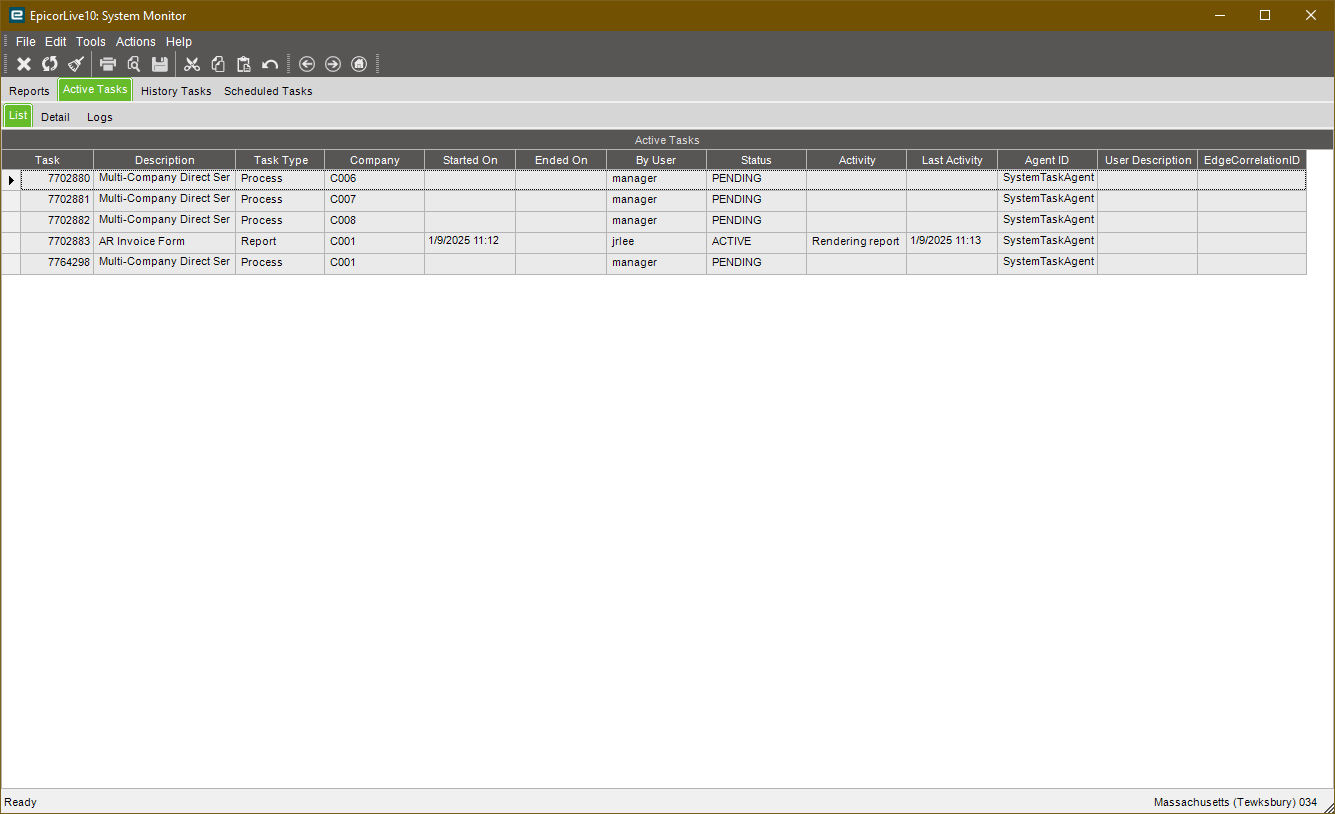

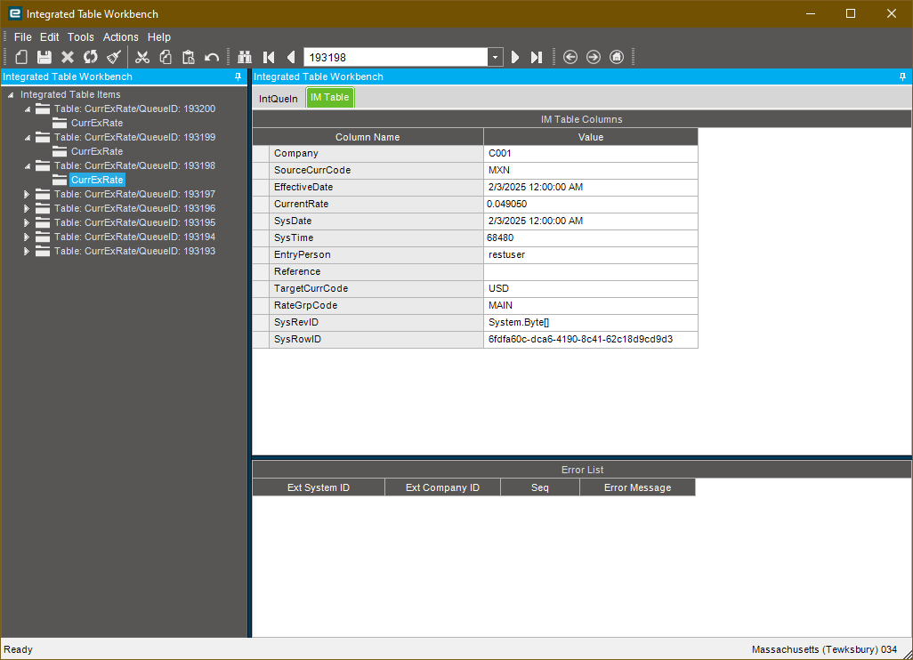

We have currency exchange records that are getting stuck in intermediate table workbench. We have a single source global currency master that once updated in our CONSOLIDATION company copies down to our subsidiaries.
This has been working flawlessly for years, but as of 1/26 any new CurrencyEx entry in CONS is getting stuck in Integrated Table Workbench for 4 out of the 8 companies. The Workbench doesn’t show any errors either
any ideas?
I can Validate and Process the records manually without issue.
Well turns out of you have “old” stuck tasks in System Agent… that’ll do it cause Multi-CO can’t start if its already running

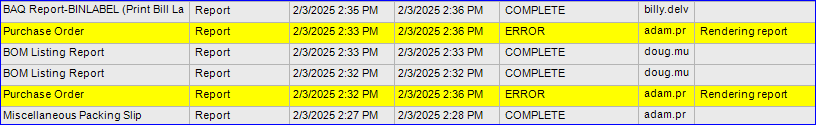

Interesting. We’ve also had reports getting stuck in “rendering”. Being cloud, all I could do was request a data fix so I could clear them. EpiCare had zero input on why all of the sudden they are getting stuck in this state.

Yeah, I guess the examples I pasted above actually had an error, and it ended up being a communication issue between the servers. That issue cleared itself up once connection was re-established.
But, a couple weeks ago I was battling a bunch that looked like @josecgomez image. Where the task still had a state of “Active”, but they were stuck at Rendering. Because there were no errors, there was nothing for me to use to troubleshoot. Some of the reports (OrderAck) would print, some of them would get stuck. I DID eventually find an issue in one of my RDD relationships that was the issue, and haven’t had the problem since correcting that. But, why they all printed fine for a couple years and recently started having a problem, I can’t say. But, I guess it did force me to fix the underlying issue (which I wasn’t even aware of until this started happening).
