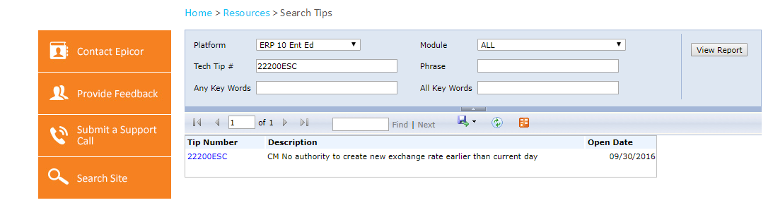

Look at 22200ESC, it has the explanation how to change this using process security.
How/Where do I view this?
Sorry, that is an Epicor support document and I don’t believe we are supposed to embed them in a response. You can find it by searching the Answerbooks on EpicWeb or maybe EpiCare.
My searches are coming up blank for that article.
Are you able to email it to me if you can’t post it here?
Email is on the way
Thanks!
I screwed up and it is in Tips vs. Answerbooks
I came across this issue again and could not remember the resolution. For anyone that is looking for the exact steps, here ya go:
