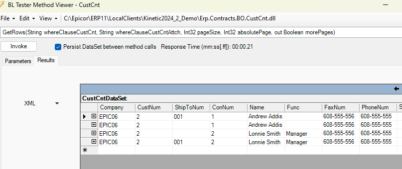

I did a get rows and interesting there are two customer contacts with the same custcnt num, but different ship tos. is it possible that you are updating the customer contact that has no ship to, but you are looking at the other record?

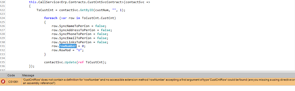

Very strange. I did see rowNumber show up in the browser trace, but it doesn’t seem to be in the CustCnt dataset?
It’s not in BLTester and I get this in Function editor:
Probably a red herring then, Kinetic is likely popping that value into the dataview that’s being fed to the BO incorrectly, and BO just ignoring it. C# is throwing an error because it’s a typed dataset, it would let you send it if you set it up as a var vs. a typed variable. I also noted that rowNumber was not present in the definition of a CustCntRow.
