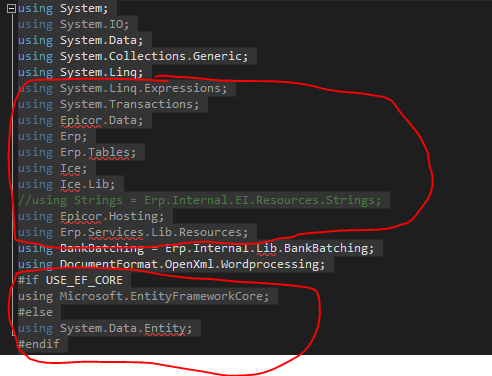

Custom C# Coding - Assistance Needed
The following code is a generic template that I was handed to customize in order to pull bank information. I would like help understanding a few things:
  1. Has anyone messed with this code before or have a better way of pulling the necessary data for the bank.
  2. The customization I need to make is limiting the amount of information that is passed along. I believe this is accomplished by commenting out the unnecessary pieces from lines 352-417.

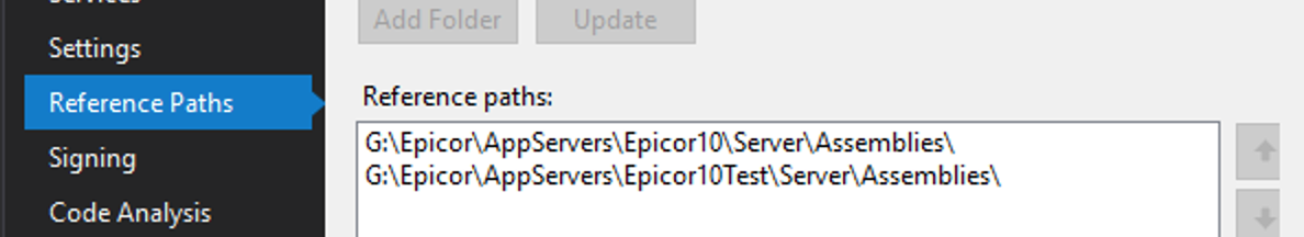

  3. I need to understand why all of the references seem to be broken on the project.
  1. Does this program need much in the means of direction? Does it need to know where to pull data from or are the place holder variables good enough in this case?
Thanks in advance for the help.

using System;
using System.IO;
using System.Data;
using System.Collections.Generic;
using System.Linq;
using System.Linq.Expressions;
using System.Transactions;
using Epicor.Data;
using Erp;
using Erp.Tables;
using Ice;
using Ice.Lib;
//using Strings = Erp.Internal.EI.Resources.Strings;
using Epicor.Hosting;
using Erp.Services.Lib.Resources;
using BankBatching = Erp.Internal.Lib.BankBatching;
using DocumentFormat.OpenXml.Wordprocessing;
#if USE_EF_CORE
using Microsoft.EntityFrameworkCore;
#else
using System.Data.Entity;
#endif
The references aren’t broken, you need to set your Reference Path
Wait @dgreenEA are you Epicor SaaS MT (MultiTenant) as your profile says? Cause if that’s the case… none of the above will work.

Could you give me a run down on how to set reference paths? Im not entirely sure where to begin with that.

System.Data.Entity is a framework reference. Right click the References -> Add Reference -> System Assemblies.
The others you’ll either have to add those references or add a reference to the folder containing the assemblies… welcome to DLLHELL
