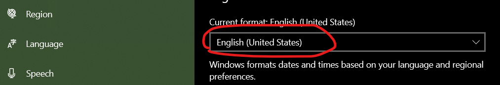

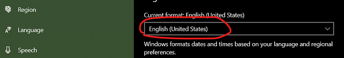

I’m replying to my last post, maybe someone has a similar problem.
After changing the regional format of Windows (from English (Europe) to English (United States),
the problem was resolved with custom programs (ie problem with downloading custom .DLL files)
