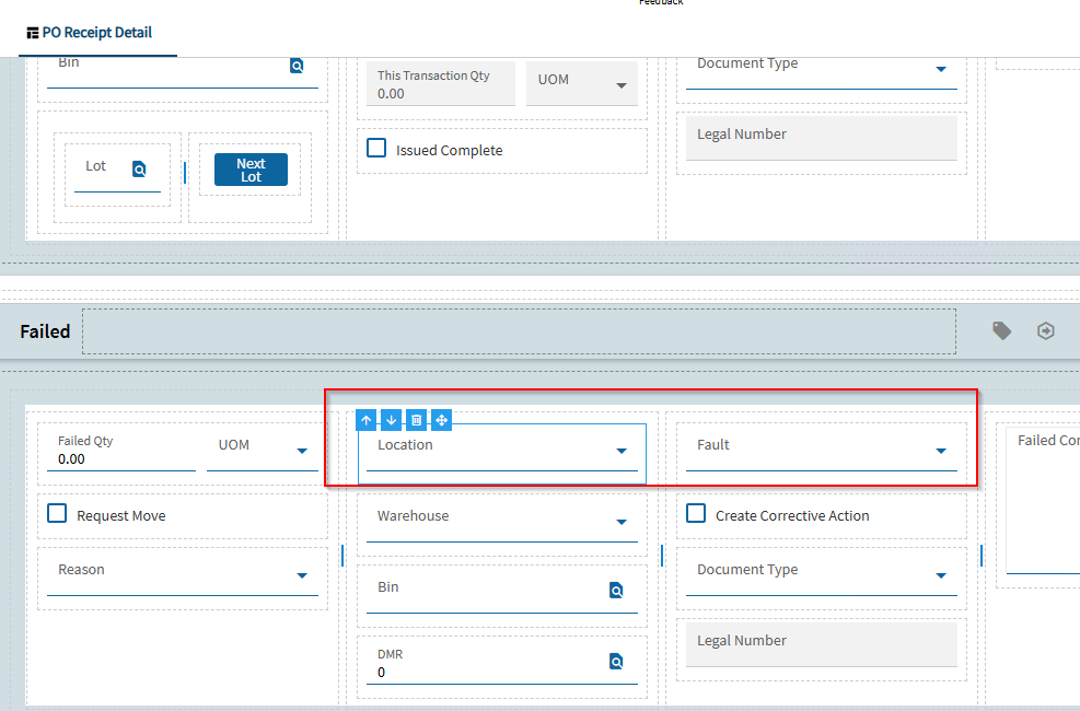

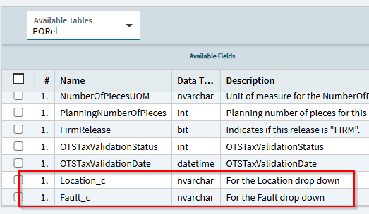

Two ComboBox controls, Location and Fault, have been added to the Inspection Processing form. I need to bind these controls to the custom fields PORel.Location_c and PORel.Fault_c.
However, the Inspection Processing form uses PORView, and I am unable to add these custom fields to the view.
Could you please advise on the recommended approach to add PORel.Location_c and PORel.Fault_c to PORView and bind them to the ComboBox controls?
Inspection Processing Form:

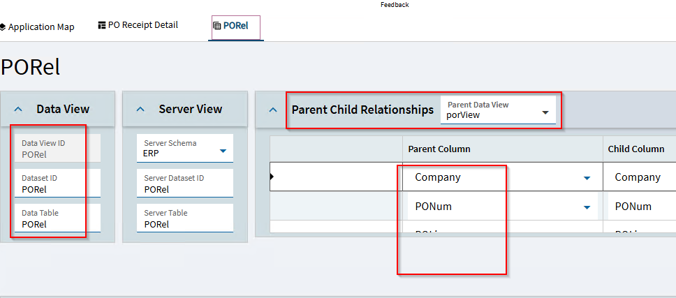

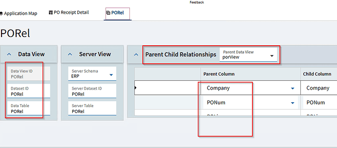

I have added a new view with a PORel relationship to PORView using the following fields: Company, PONum, POLine, and PORelNum. I have also bound the controls to PORel.Location_c and PORel.Fault_c.
Is this the correct approach?
binding of the contols are Porel.location_c and Porel.Fault_c because these columns not in porview
is there any way to add these columns in porview?

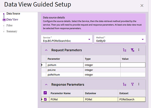

I would do this by adding the PORel dataview, like you did. I don’t know if you need the parent/child relationships defined.

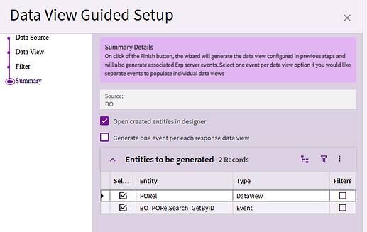

Personally, i would delete your existing dataview, and recreate it via the dataview wizard.

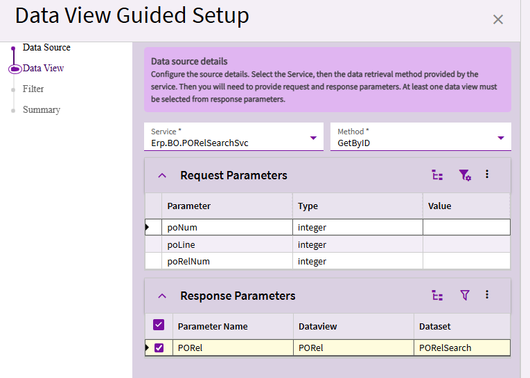

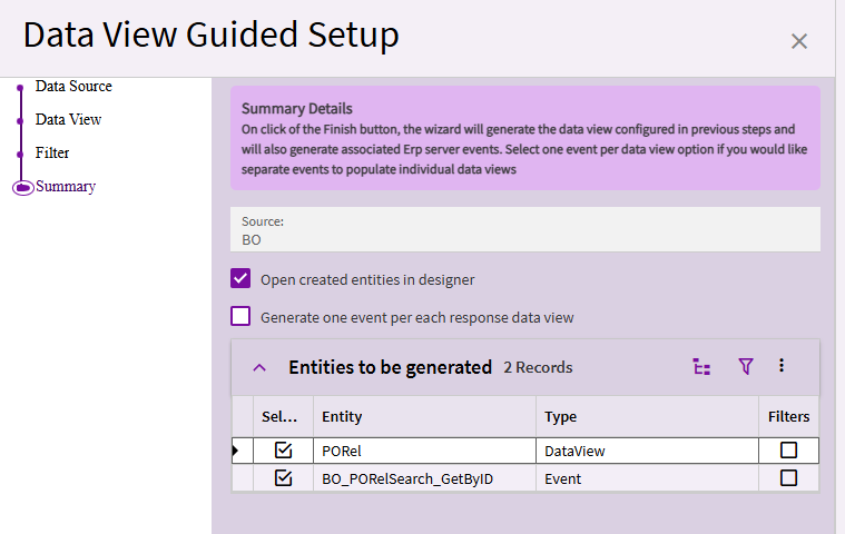

The wizard will create the PORel dataview and the BO_PORelSearch_GetByID event for you:

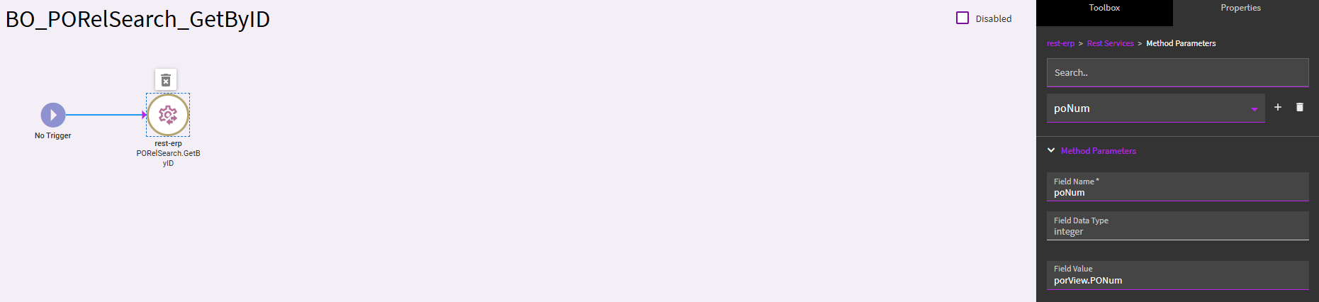

In the created event, set the method Param to use the porView PONum:
Repeat this for the other two parameters, using porView.POLine and porView.PORelNum
The Response Params should already be set up for you:
Then you can bind your two controls to PORel.Location_c and PORel.Fault_c.
You then need to figure out your trigger for this event. But this should perform the rest call to populate the PORel dataview and return the PO release based on porView’s PONum, Line & Release.

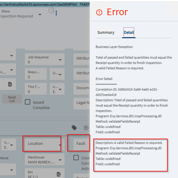

Error:
Location Combo → UserCodes.UserCodesCombo → CodeTypeID = Location
Binding: PORel.Location_c
Fault Combo : UserCodes.UserCodesCombo → CodeTypeID = Fault
Binding : PORel.Fault_c

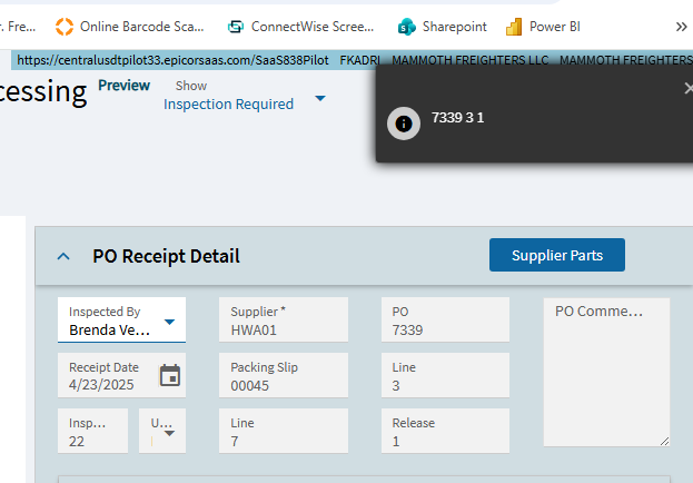

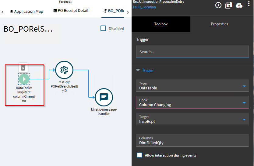

Event BO_PORelSearch_GetByID Loading the data into PORel
When enter FailedQty: Data loaded with successfully
Issues with when click on location/fault drop down
Inspprocessing.dll called
binding problem specifically related to:
Binding =PORel.Location_c and PORel.Fault_c
remove the binding Controls remain disabled
The error is likely that PORel and porView are not the same data view, so when you click a control bound to PORel, it’s going to trigger the event ViewChanging, which then updates the screen.
What may be easiest is to create the Location and Fault fields in porView, then after the rest call to GetByID, copy them from PORel → porView in a row-update. Rebind the controls to porView, and it shouldn’t trigger the event again.
Make sure you can update the fields, if that’s your intent. If so, you’ll also need column change events on porView to copy the values back as they change.
What is the network call? You should be able to see the view being filled from the server. Then you will also see if your fields are even in the call.
