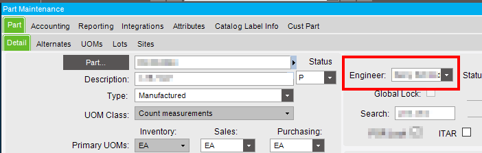

So a while back, we had two customization done to the Part Maintenance application.
1.) We had a custom field created called Engineer, shown in the image below.
Basically this field contains a drop down list of our Engineers that quote parts. When a new part is entered in Part Maintenance, the engineer who quoted the part is manually assigned using the drop down. The list of engineers is controlled by User Codes, shown in the image below.
2.) The second customization was to the Status drop down that defines a part as New, Developing, or Production status.
This field is also controlled by User Codes.
The thing about these fields and the customization done to them is that they were set up to only allow the ‘master’ (our Manufacturing Engineer responsible for entering methods) to set and modify these fields. NO one else can make changes to these fields and they are actually grayed out to everyone else. The issue is that at the time we only had one person who entered methods, so having one master was fine. However, now we have two people responsible for entering new parts and methods. So I need these fields to allow the master and another person to set/modify these fields. I know there is coding logic behind it somewhere checking the users credentials to see if it is equal the defined ‘master’, but I am not sure where this logic would be.

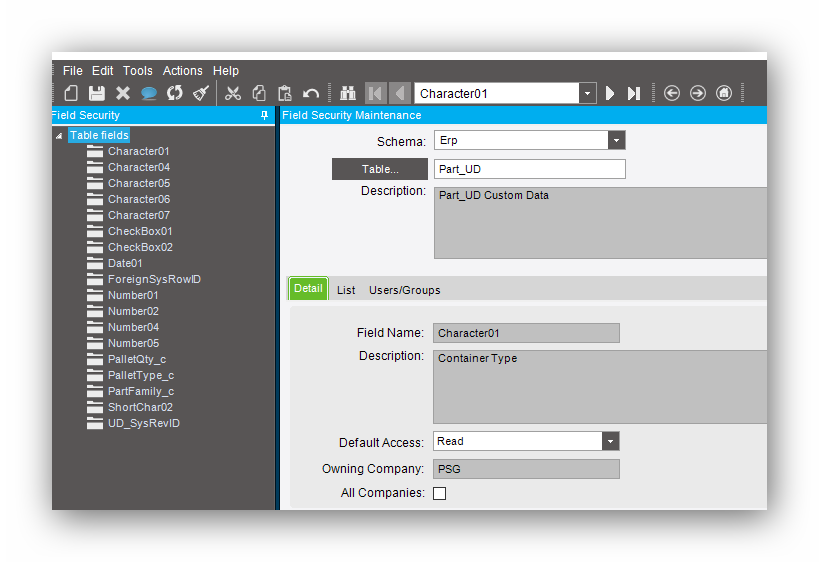

Try Field Security Maintenance. That’s where you can set certain fields to full access, read-only, etc. on a user-by-user basis. It’s located in System Setup > Security Maintenance and you’ll need to be a Security Manager to access it.
They could have also created a new security group to use in addition to the field security maintenance (hopefully they did, easier to maintain). If this is the case you would just need to add whichever other users need access to that group via “User Account Security Maintenance” module.
I am setup as a Security Manager in the System. I followed your direction and I did notice on the Part_UD table for the custom field, the user I want to have access didn’t. I changed it to full, but that only gave them the ability to see the data in those fields on the part maintenance screen. The fields are still grayed out and they cannot interact with the drop down menu arrows. They do however have the ability to now see and make changes to the updateable dashboard for these fields. So we are getting closer. Any other ideas? Like I said they did make a customization to the Part Maintenance application itself, could this have logic behind it that could be causing them not to access those fields?
I didn’t see anything like this…
