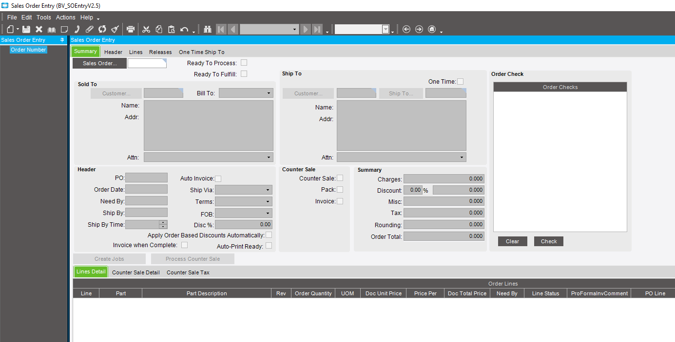

On the Order Entry screen, I want to have a grid with some rows telling the user info about the order they are working on:
Basically our customers are very predictable, and order the same products and very similar volumes each week. Even to the point of taking delivery on the same day. This allows us to spot possible order entry errors, and correct them.
I want to populate the grid with rows containing a name, then description of the issue:
I will have to write the C# code to work out the answers to those examples that I posted. My actual query for today is how to populate the non-bound grid. Do I go after the rows in EpiUltraGrid, do I bind it to an EpiDataView, or a DataTable? I want to know best practice.

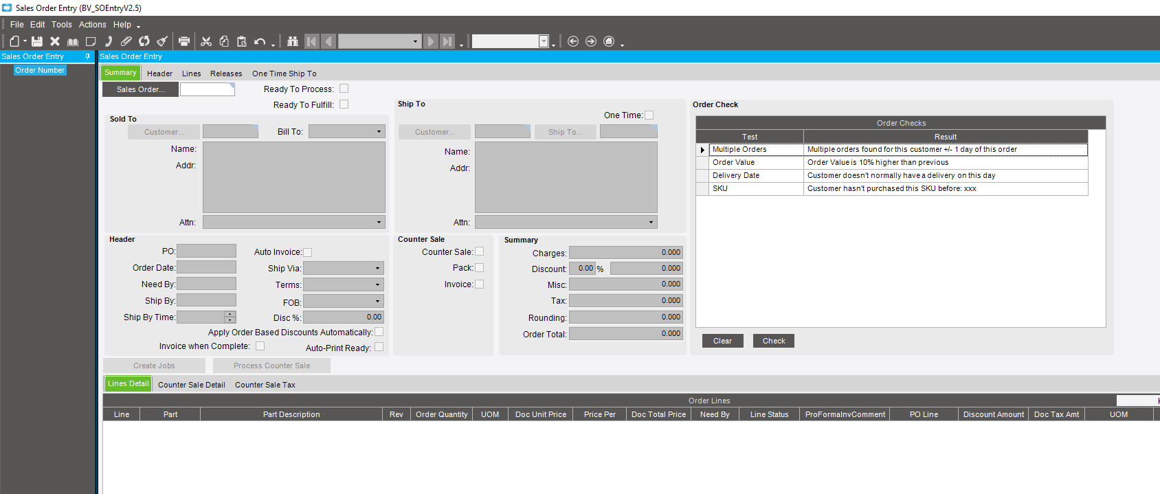

With your help I’ve been able to mock up using code what I want to achieve:
I have a meeting now, but excited to get back to this and hook up the dynamic elements to check based on the currently loaded order. Final challenge is to wire it up so that it works automatically. That raises the question about when the order is “finished”. If I fire it after 1 line, and the customer normally takes 5 lines that it’s immediately going to fail on the Order Value check. I might need to retrain users to click ReadyToProcess once they think they’re done, and use that the do the checks.
