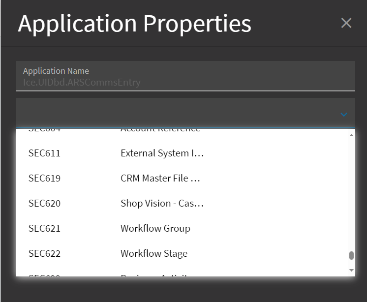

Owner of the application can share the Base application editing by applying a security group to the application, steps would be like
Click on the Properties Link of base application
New slider would be displayed to choose the Security Group
Save application and Publish. All the users part of the selected security group would be able to modify the application.
