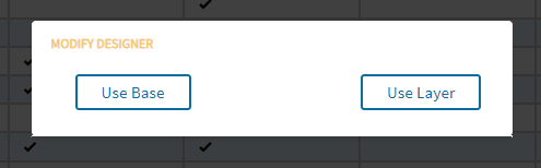

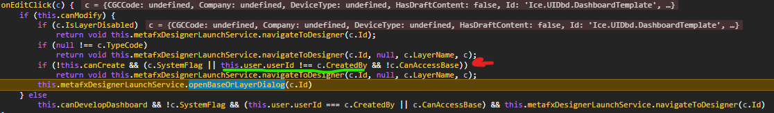

I found the Javascript in the browser that is invoking this dialog, it looks like they have set it so only the author can modify base of their app.
This gave me the idea to force CanAccessBase to true for all Non System apps.
I did this by creating a post processing BPM on Ice.Lib.MetaFX.GetApplications with the following code:
foreach (var row in result.Where(o => o.SystemFlag == false).ToList())
row.CanAccessBase = true;
Dialog now shows!
