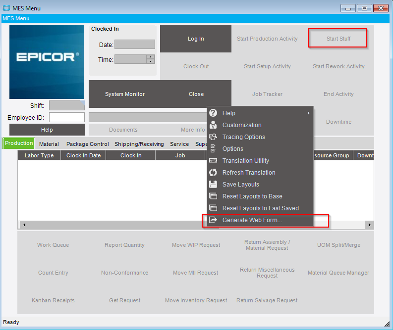

does anyone know the url you would use to call a custom MES menu through EWA?

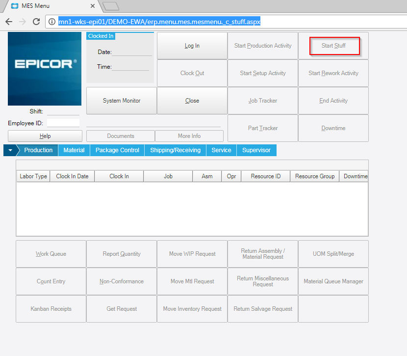

You have to first generate a web form for your custom menu like this from MESC (MES Customization Mode). Make sure your company settings have the EWA site and Metadata folder specified. Once the form is generated it should open a link in the browser to something like this (http://MYSERVER/DEMO-EWA/erp.menu.mes.mesmenu.**_c_stuff**.aspx)
