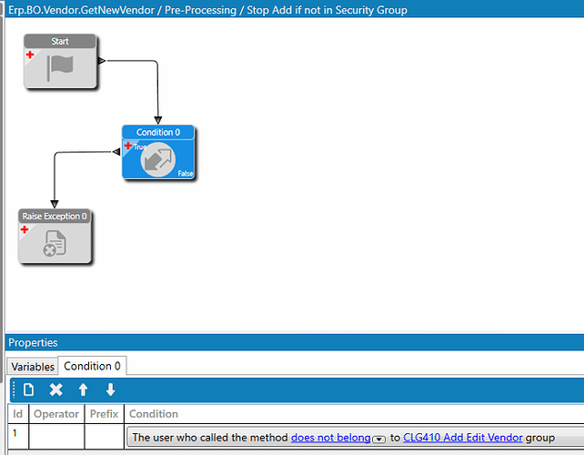

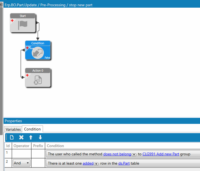

Below are bpms we use to stop new Parts and Vendors. We do not stop new customers, but I have a bpm that makes them all suspects and only allow accounting to change them from Suspects to Customers. You can also do the same for field X has changed from any to any and User is not in Y security group with a message referring them to a user that can make that change. If they are all bpms it does not matter what UI/UX you are using.
Vendor GetNewVendor
part Update
