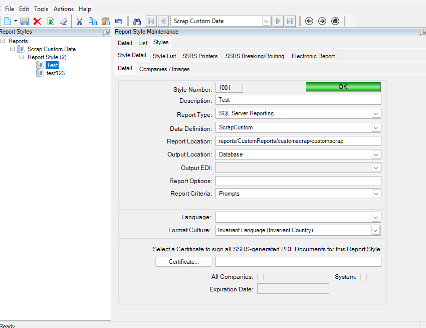

So it seems to me that the report location must be auto-completed upon report creation/re-establishment. When copying a report style, you do have the opportunity to specify a new folder. I GUESS this is where the possibility of an issue is introduced.
Also unclear is when and why the report will fail post-update/upgrade, but at least we have a pretty good knowledge base here to work with.
Awesome, this is great to know as I didn’t do it that way either. I’ll have to keep that in mind when creating these to not change the locations. I guess that just makes me wonder how you are supposed to have multiple report styles without specifying the location. It will attempt to overwrite the existing if you leave the location blank(It also does it if you specify the location). Seems to still be a bit of a disconnect. Either way that is great information, thank you!

One quick clarification about creating additional styles…
You get to specify a new description for your style, which is used as the name of the copied report. This is the differentiation you’re looking for (in additional to the Style Number).
The problem seems to be that we also have the ability to specify a folder IN ADDITION to the description. I use this capability all the time in order to organize my reports. I think we need to pay attention to this aspect.
Correction to this post: When copying a style, we MUST specify a new folder in the “copy style” dialog box in order to have Epicor create a new (additional) RDL. The name/description of the style is inconsequential. The Folder is used to separate distinct styles.

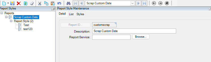

Absolutely! That’s interesting I just attempted that in pilot and it will only go based off the report ID. Which in this case is Custom Scrap, so in other words it is overwriting regardless of the description. Any ideas? I would think the only way around it would be to make a new Report/Report Style.

Totally fine, I need a good picture drawn once in awhile. I guess my confusion at that point would be how would you have different data in the same RDL? Wouldn’t you need a new rdl no matter what?

If your concern is what’s happening in the Report Location field, just make sure your description AND FOLDER are different and you will have a different style.
Also, don’t “create” new styles. You have to COPY an existing style and rename it to what you want - specify the folder name (as the style is copied) as you will NEED a separate folder for each different style.
