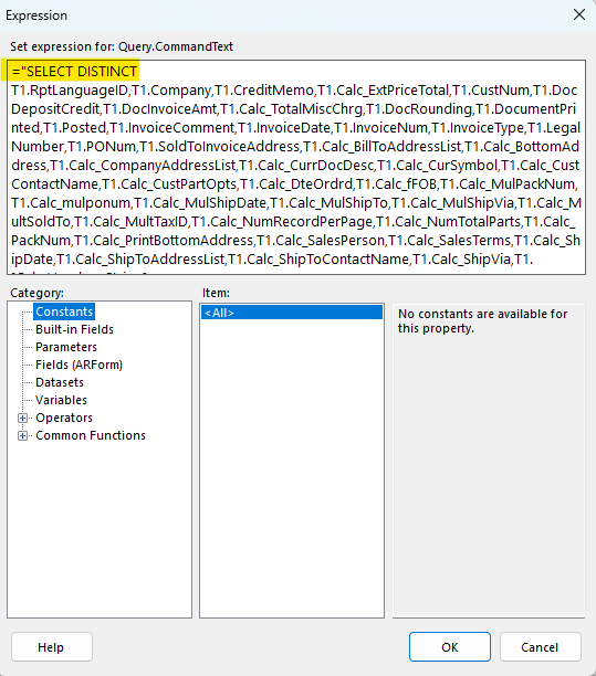

I think we had this issue a while ago and I found some advise that suggested updating the dataset properties as shown in the pic

That’s interesting Tracy, I will try that.
I have actually now completed a copy of the original that works perfect so I will overwrite the original with it, but I will try this first to see what it does.

Brilliant! thanks Tracy, that fixed it in a tiny fraction of the time I burned through yesterday!
