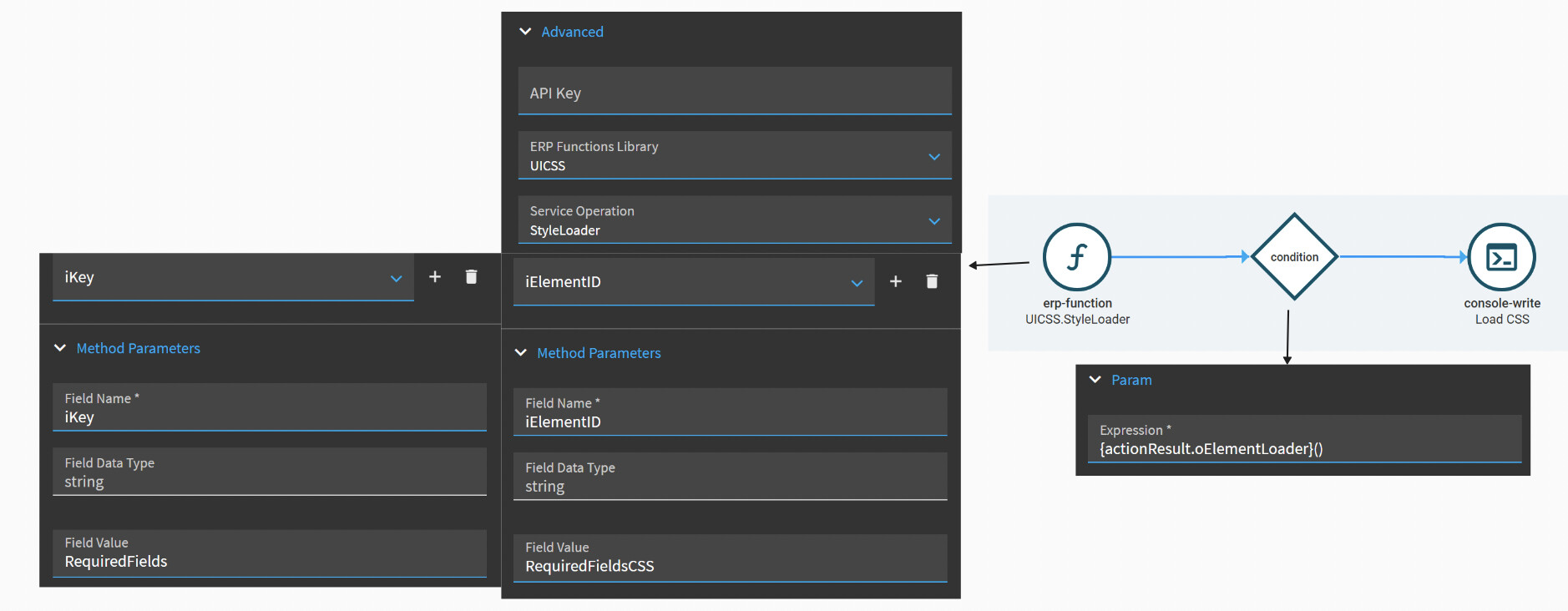

For using CSS, you can approach it a couple of ways.

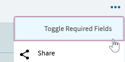

  1. Call the Epicor Function and then the condition element to either load or unload the CSS. This is a simpler approach if the CSS isn’t going to be toggle often. Like if you just want to give the option to toggle required fields.
  2. Store the loading and unloading logic in TransView fields and then use those fields in the condition element. This would just save on making server calls if the CSS will be added/removed often. Like if you need to toggle CSS based on a field/row change.

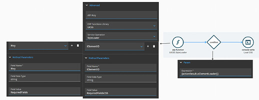

This is the basic routine to Load CSS:

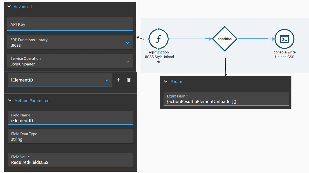

This is the basic routine to Remove CSS:

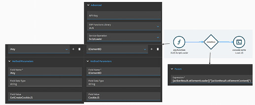

This is the basic routine to Load JS:

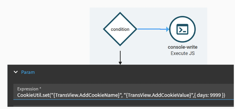

This is the basic routine to Run JS:

The expression to load JS is a bit different because I couldn’t find a way make the condition like the syntax when it all came back in one string, like the css loader does.
The JS can be a bit tricking to both write and store in a function. When using a verbatim string, it doesn’t like the JS key words (let or var) sometimes.
Also when trying to use the condition to load the JS, it doesn’t like double quotes in the code, it throws a syntax error. It must do some quote escaping. So you will notice I used backticks instead.
