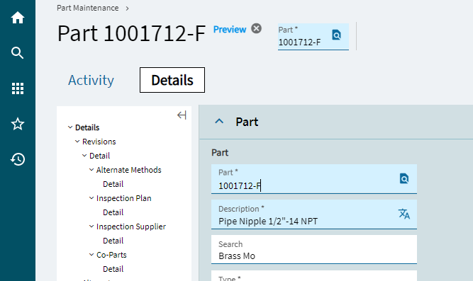

New background color options would be great but in general it’s great that the new background colors are a million miles better than the E10 ones which were way too dark. I hope any changes maintain the more transparent/light color styling. And that text label text can always be black instead of a hard to read color like the below.

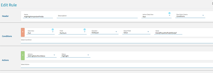

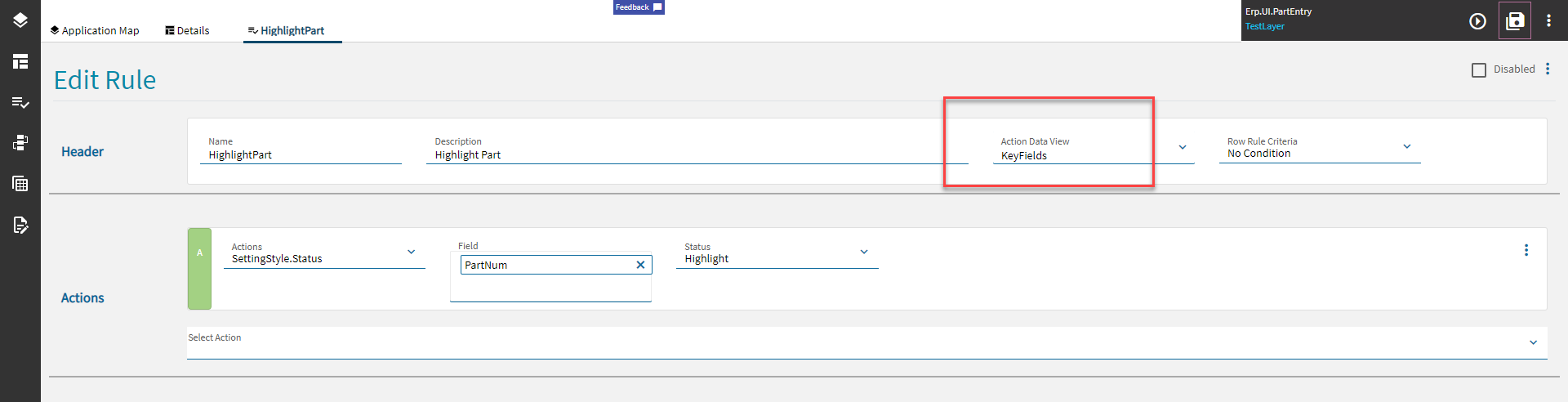

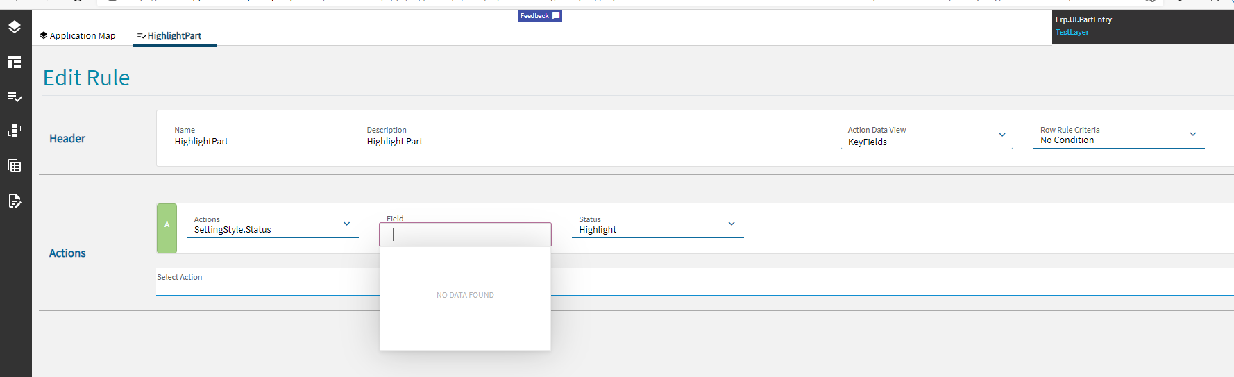

So, should this rule be highlighting the PartNum field? It doesn’t appear to be working.
[edit]Oops, I think I should have chosen SettingStyle.Status[/edit]

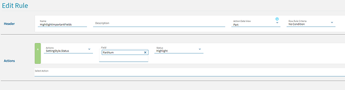

Hmm, still doesn’t seem to having any effect on the PartNum field.

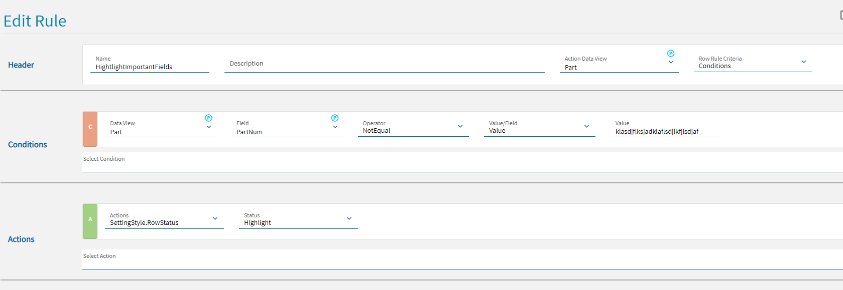

Make sure you get the correct DataView.
**Not entirely certain why it’s highlighting the Description too, though.

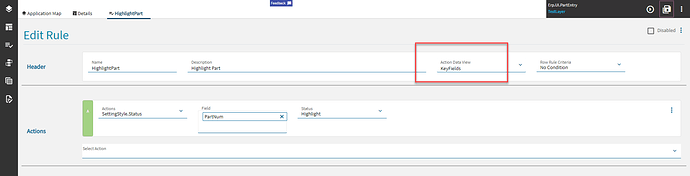

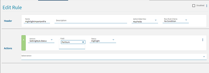

I had tried the KeyFields view as well, but it didn’t have any effect either.

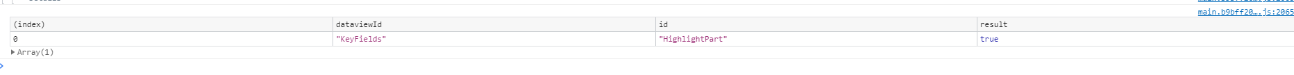

Preview your application, then open the dev tools (F12).
Press CTRL+ALT+8 to start debugging.
Open a part number to go to the detail screen, then press CTRL+ALT+2 to view the active rules.
Does your rule show up?
***The debugging is when you run it in the browser, not the smart client.
Unfortunately, we cannot currently use Kinetic in browser due to some issue with Azure AD that support says is getting fix in an August release.

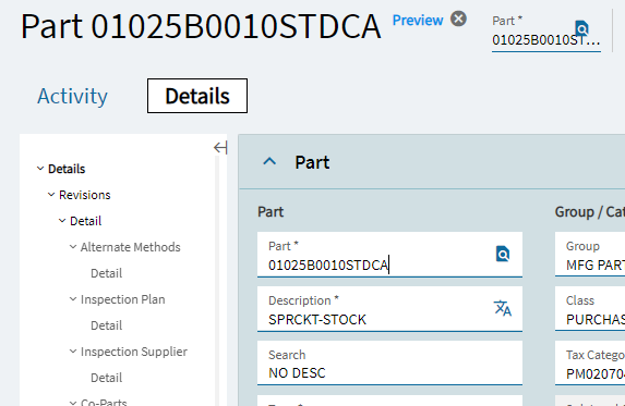

Huh. Interestingly, mine does not highlight when in the smart client–only the browser.

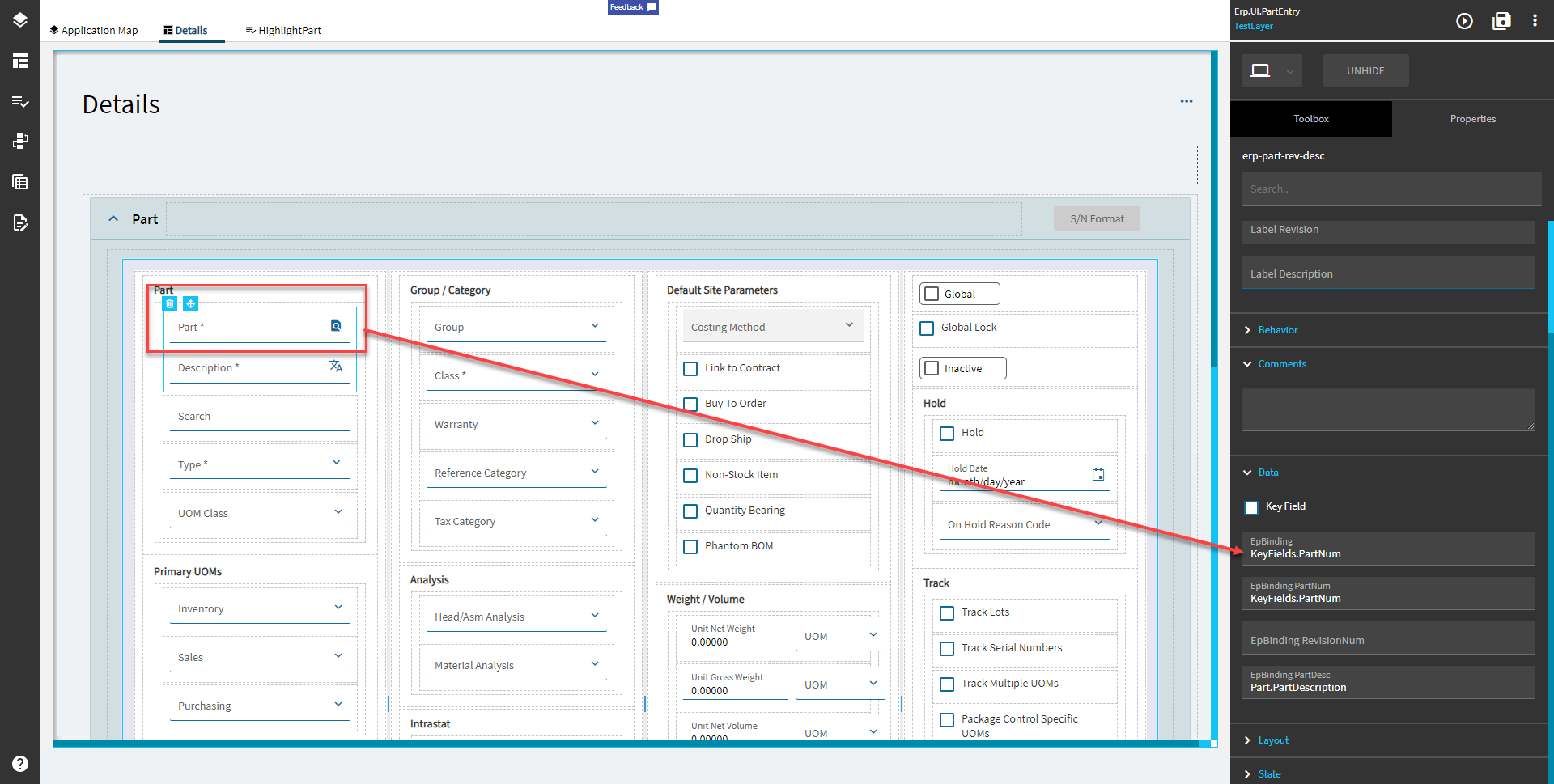

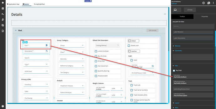

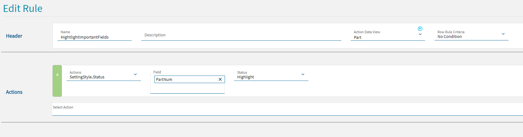

Curious to know if you typed in that PartNum field… Or was it selected from the Combo?
Suggest try forcing it to select from the combo list.
I don’t know about @fvodden, but that drop down does not usually populate for me.
It did not populate when the KeyFields view was selected. It does if the Part view is selected.
