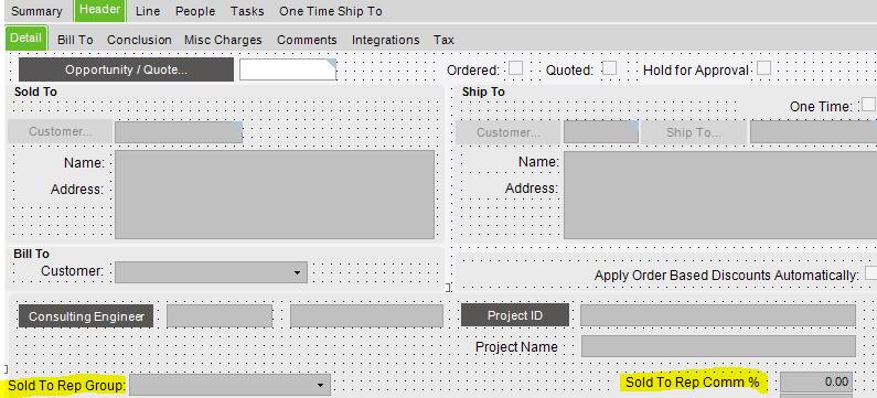

What would be the best way to set for example Quotehed.Number01 to be blank if Quotehed.Character01 is blank otherwise be set to a set number.
What are you trying to achieve?
Reference below. Goal is to have “Sold to rep comm %” populate with “3%” if there is a “sold to rep group”. If no “sold to rep group” is populated then the “Sold to rep comm%” will be set to blank/null ect. Quotehed.Number01 is epibinded to “sold to rep comm%” and Quotehed.Character01 is epibinded to “sold to rep group”.
I’m looking for something like this I put together but not sure this will run without errors.
