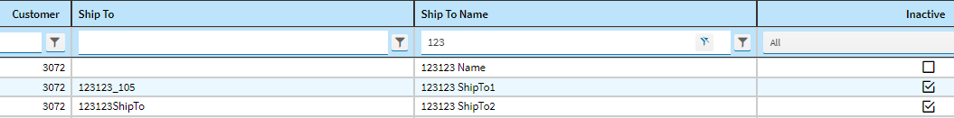

I noticed something interesting when I changed a Ship To search field to only show Active (Inactive = False) ShipTos. Even if I mark a customer Inactive, it still shows as Active. I then tried to do a PreProcessing Directive off of Customer Update that has a condition to check if Inactive is True, if so, Fill the ds.ShipTo table with the data from the Customer table, because ds.ShipTo passes as empty on a regular Customer update. I passed ds.Customer.CustNum as ds.ShipTo.CustNum, Company to Company, Inactive to Inactive, and left ShipToNum as expression “” because the BAQ shows the ShipToNum as blank for the Customer ShipTo but I get a 'Duplicate Ship To ID or invalid Characters in Ship To ID" error. Any thoughts on this?
Ideal turn out would be: If I mark a Customer as Inactive it would also mark that Customer as inactive in the ShipTo table. Below is a screenshot of the BAQ that returns the Customer and both of its ShipTos. The Customer is Inactive but its ShipTo is active, and I can’t find a way to inactivate it.

Interesting. If you notice in your screen shot, the NULL Ship To is already Inactive. My guess is that is because that Ship To is controlled on the main Customer screen and you marked it Inactive.
I think I already know the answer, but will ask anyway. Are either of the ones that are active Alternate Ship Tos on the Customer or Alternate Ship Tos on another Customer?
I think it’s showing that the null ShipTo is the only one that is not Inactive…
Yes this is true. Where Inactive is Checked, that means it is Inactive. The screenshot is showing the Customer is Active in the ShipTo table, and the Customer’s ShipTos are Inactive in the ShipTo table
:laughing: :laughing: Read that backwards.
So, the Customer is Inactive, but the Ship To is not. That is odd. I would think that setting the Customer as Inactive would make the Ship To inactive. I wonder if it is a sequence thing? If you make the Customer active again and then inactive, what happens?

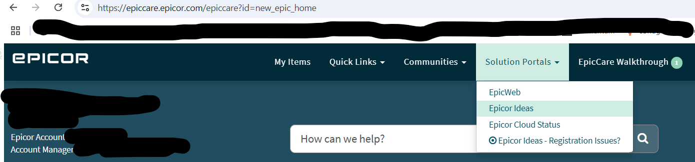

Where do I put those ideas?
Epicor Ideas - if you have an EpicCare account, it’s available in the Solution Portals dropdown
