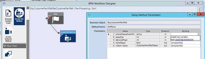

The GetRows method can be modified to add a sort.

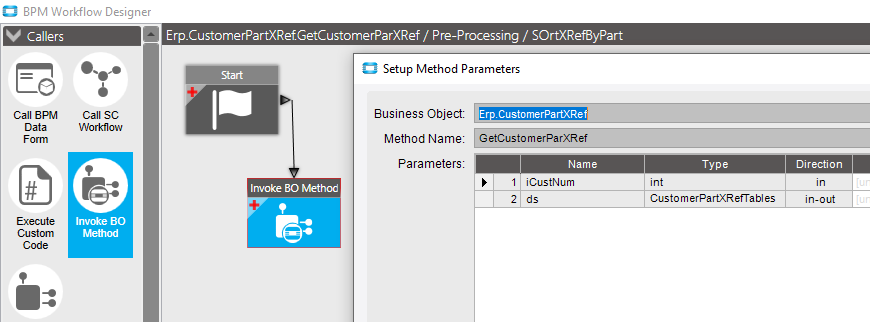

I have but BPMs on methods but have never actually changed the method itself. How does one do that?
The whereClause can end with “BY XPartNum” in Pre-processing
Thanks Jason,
I have t say, that it seems strange to Invoke the same business method from the BPM… But I couldn’t see a where clause:

That particular method (GetCustomerParXRef) takes only one parameter and that is the custNum. It then fills the dataset with all the records for that CustNum. Jason suggested the GetRows method. I think you’ll find your whereClause there.
Mark W.
Thanks Mark.
I’ve launched this from the CustomerPartXRef BO (The Get rows method is not called as far as I can see from the trace …)
It doesn’t throw any errors but it doesn’t actually do any sorting either …
Not sure Rob. Unless there’s a sort routine on the tree component undoing your BPM work.
