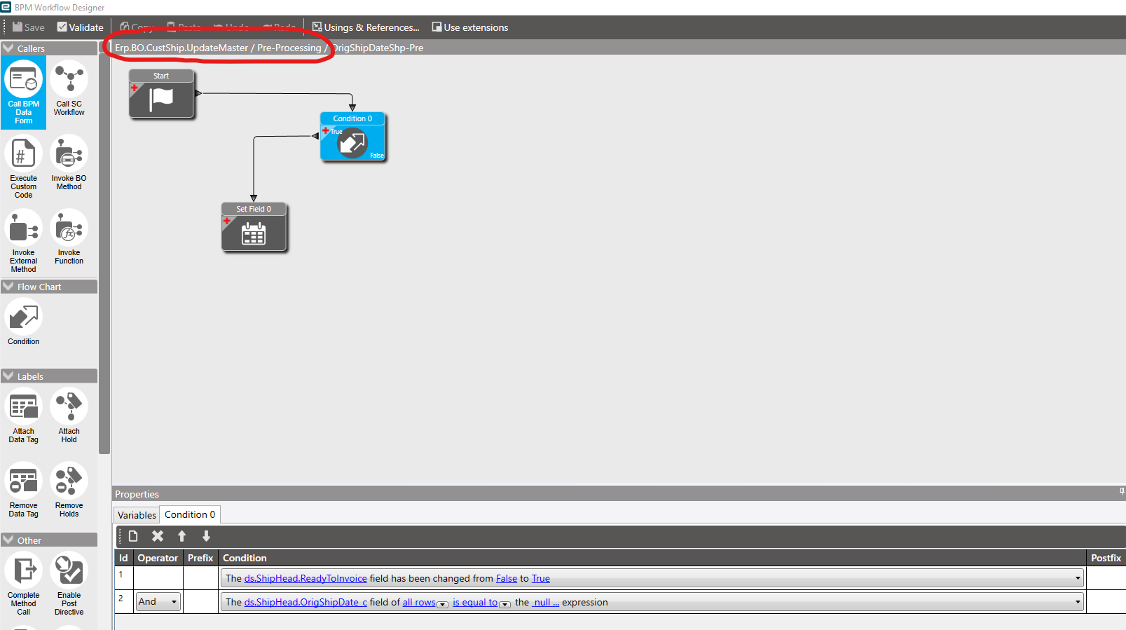

We have a UD field that stores the original Ship Date if the Ship Date was changed. This BPM updates that UD field if the shipment is shipped against the original ship date so you just need something similar with the correct conditionas and to set the field to the current date:
I’m afraid this is not straight forward. I did some tests and I can’t find a method to do this properly. The UD field as @tmat suggested is a good idea. Also, I would just make a BPM to restrict the shipment if ship date is not today. Then users will be forced to change it to today’s date.

Sure, BPM on method directive CustShip.Update.Pre:
I dont get any warnings come up when i test this, the only differance i can see is that you have ERP.BO.custship and we have just ERP.custShip other than that there is no differance.
Cheers again for everyone who has helped along the way
Got it working works great thank you for the help.
