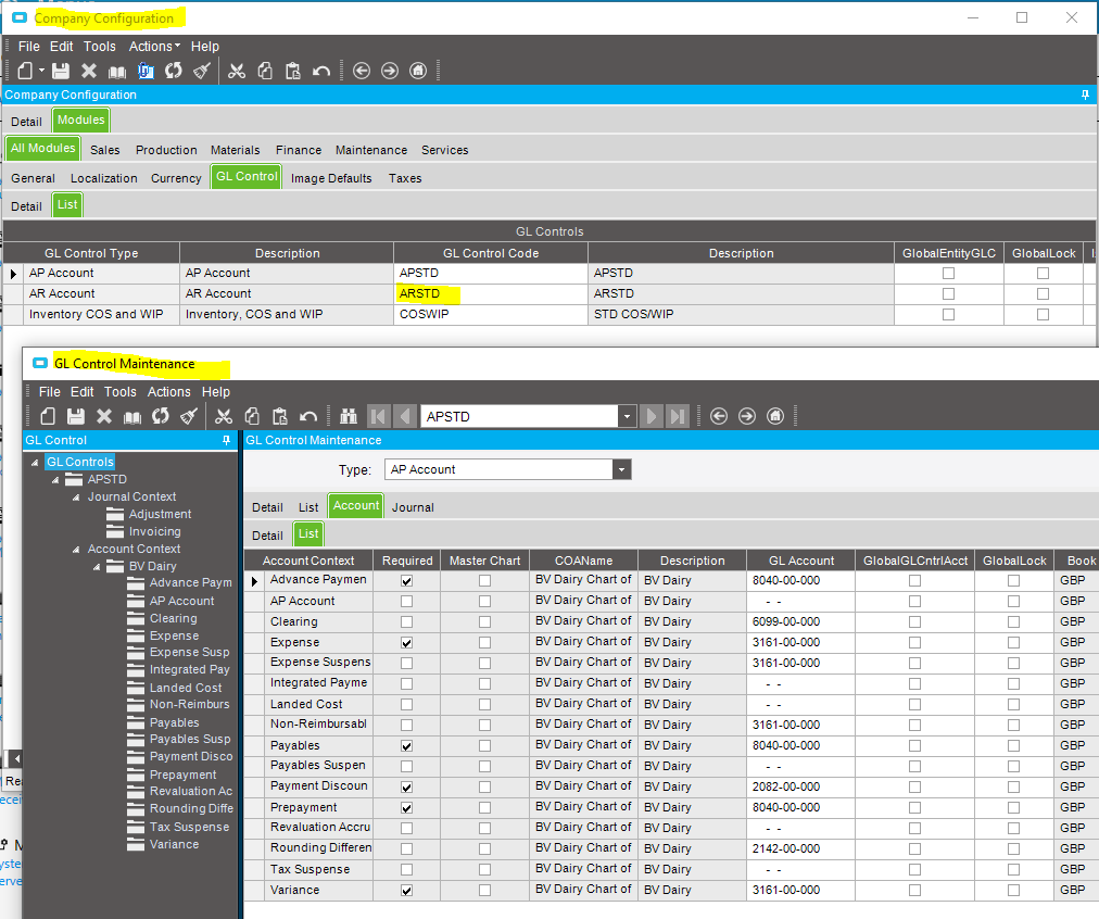

Sounds like the GL context for AR Clearing. Check the GL Control Code that is setup against the AR at Company level. In either Company Maint or Company Config, you define the INV/COS/WIP and a couple of other control codes. One of the applicable contexts on the AR one is clearing - I guess that is set to GL = your suspense account.

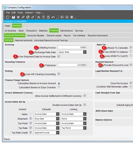

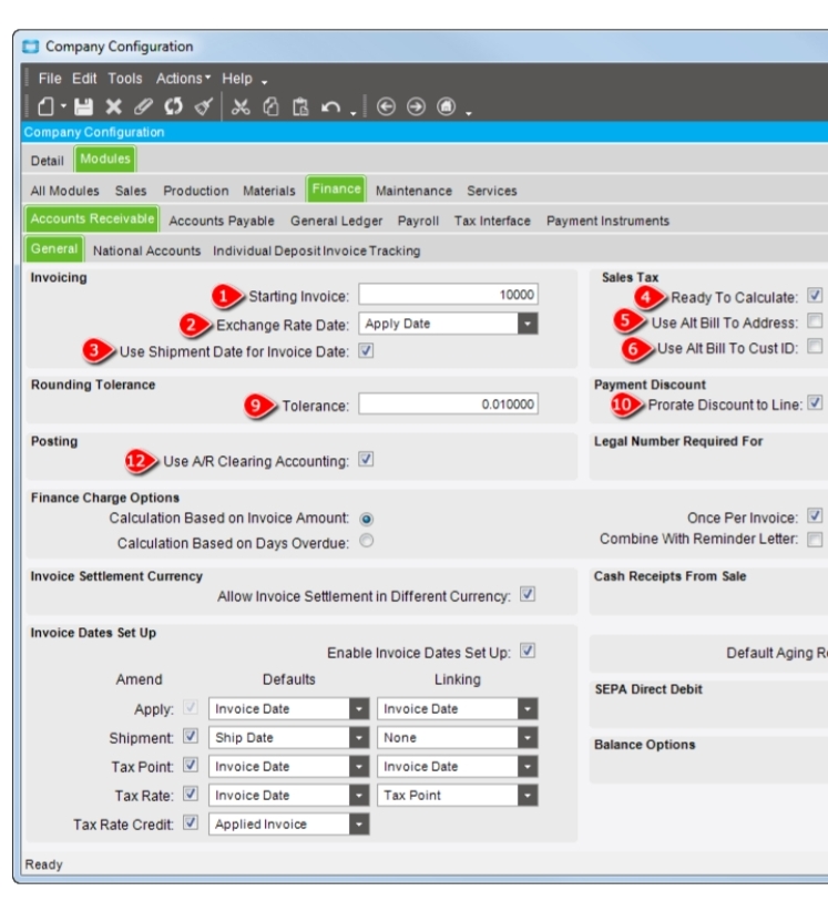

Number 12 in the image below
I wasn’t in front of a PC when I posted yesterday. Here is the screen I was referring to:
Couple these with the screenshot from Calvin, and that’s the full answer.
