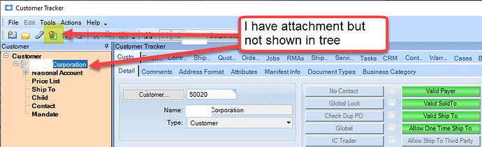

I have an attachment on my customer record, and can see it in Customer entry tree structure. However, in customer tracker, per below, I can only see it via the little paperclip asterisk icon. Many of our users are more experienced with seeing attachments in the tree. The dcoument type is setup for “expose in tree”.
Is there a setting on a table in the system that tells epicor in a program to show attachment in tree? I looked in menu tables but can’t find anything and thought I’d see if anyone here has found a variable at program open that makes the nodes shown or not. Many other trackers show the attachment nodes…I don’t know why customer tracker doesn’t. (E10.1.600.20)

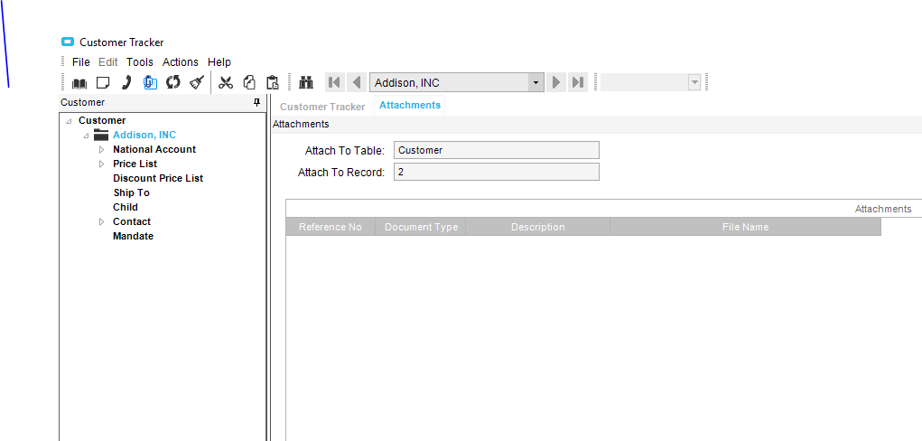

Action Menu - > Attachements

Yes, thanks Surendra ~ the problem with this is that we still don’t see the attachments in the tree structure for customer tracker. The users are so used to tree structure they don’t even notice actions nor little paperclip method…
Nancy

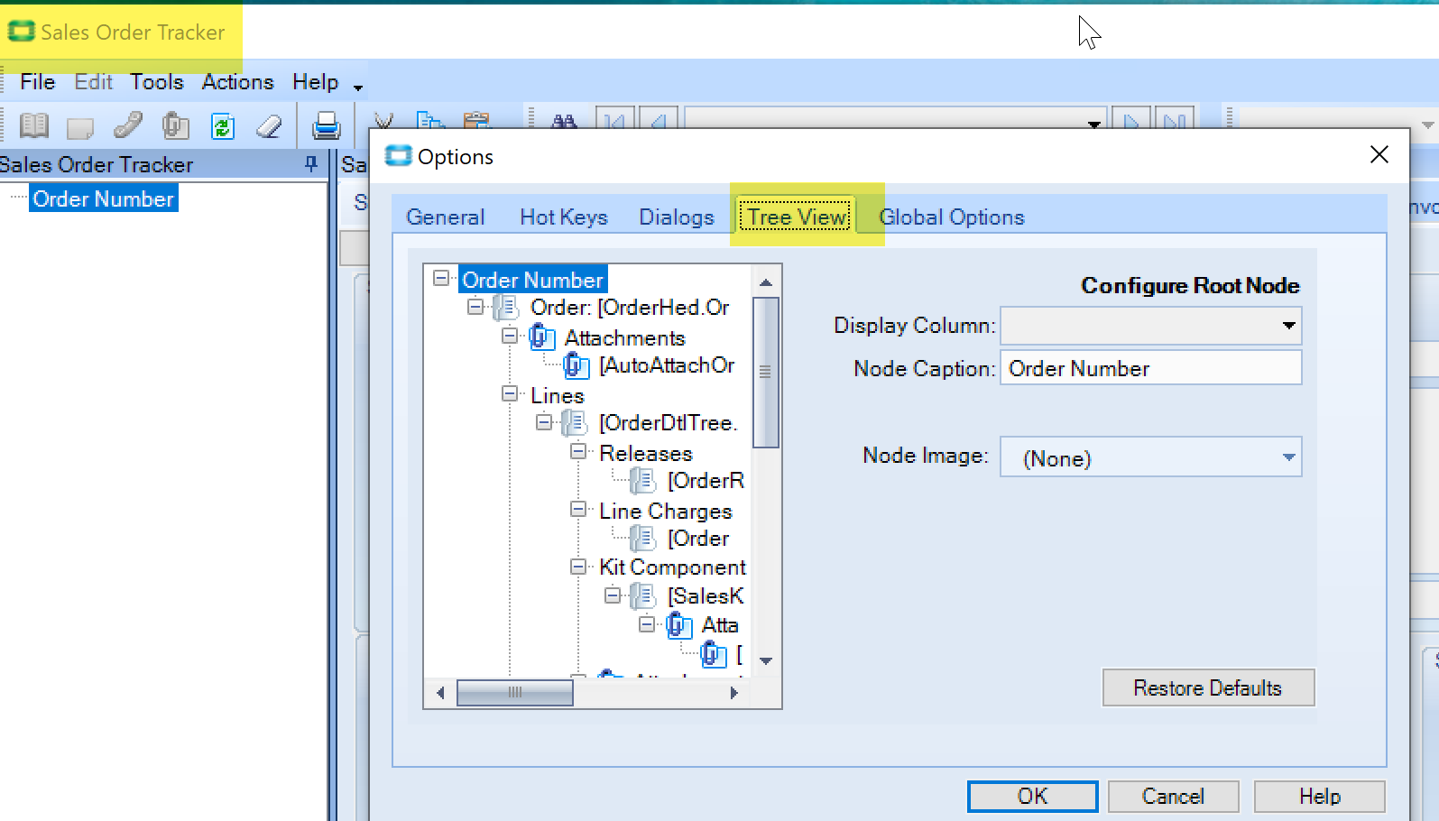

The way I can makes changes to the Tree format in Customer Entry is with Tools -> Options and then the Tree View tab on the Options dialog (like you show)

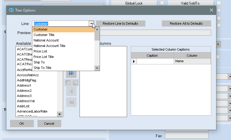

In Customer Tracker, the Tools -> Options presents a dialog without a Tree View tab. I have to right click on Customer in the tree pane, and select Tree Options to bring up the Tree Options dialog - which is nothing like the Tree View tab in the Options dialog of Cust entry.
