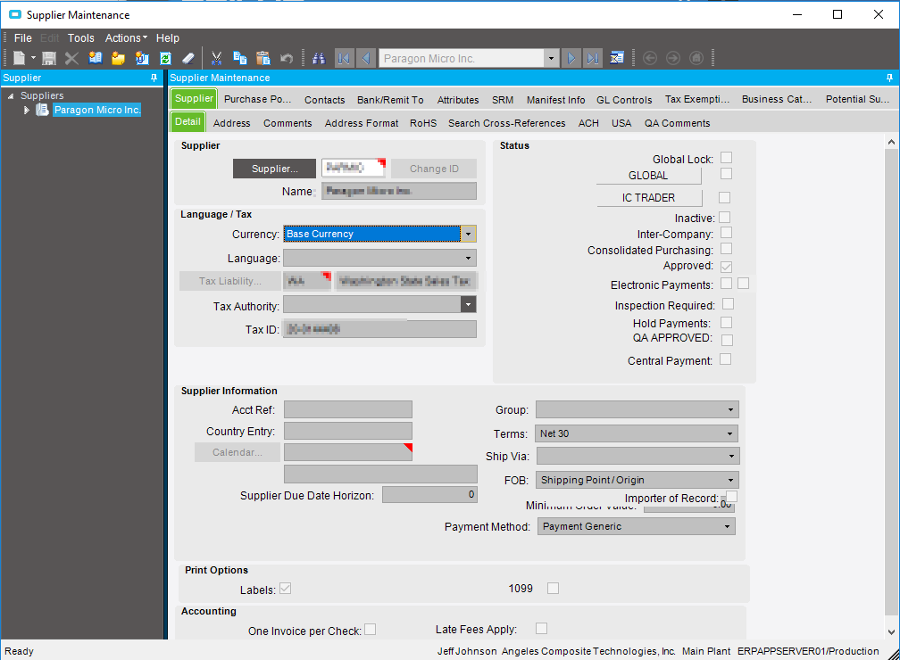

All the customization does is add a few UD fields to the form, zero code done. However, when launching the form with that customization it makes all of the fields read only.
Anyone run into this before? I’ve gone to customization maintenance and validated it.

Here’s a screenshot and the customization. Appreciate the assistance!

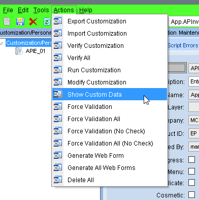

Look at the customization in Customization Maint.
then use
I’d look at the Enabled Property of the Form.

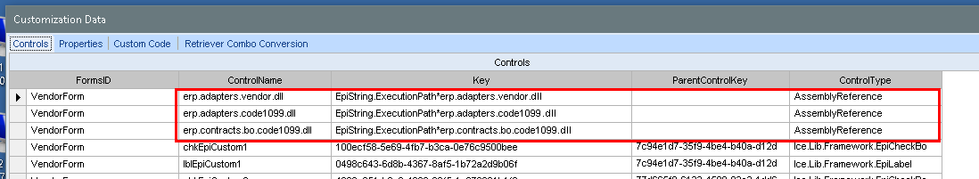

I imported the customization (but I don’t have the UD fields that you do).
I don’t normally see
Assembly references in my customizations that have no code.
I’m going to remove the bindings to the custom controls, and see if I get the “Read Only” issue.

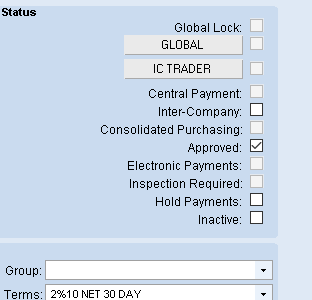

@jeffj - Even before tweaking your customization, I don’t have the issue with all fields being R/O / disabled.
The base form (after loading a supplier record)
Your customization (after loading the same supplier record):

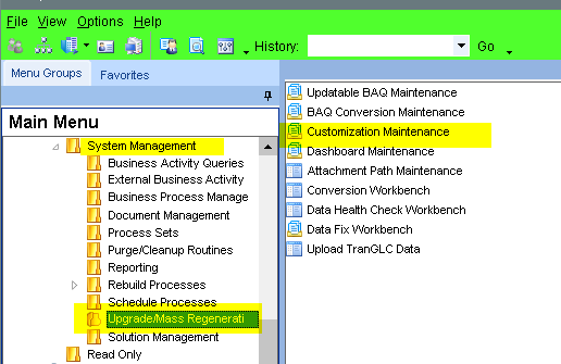

Any chance the menu item you are launching it from is set as Read only?
Well I’m glad it’s Friday. That’s exactly it, Read Only was checked. No idea how that happened. I’ve never used that checkbox before, didn’t even realize it was there.
Thank you so much!
