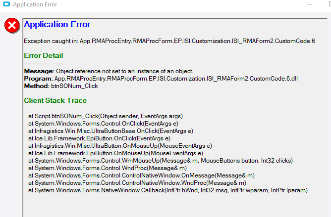

Thanks @Aaron_Moreng and @Jason_Woods, with your clues I was able to get the Sales Order Search dialog to open, crashes after selecting a SO and clicking OK. I’m sure it’s that I don’t have it set to write back to the UD field correctly. The syntax is from the wizard except the Table_UDField named.
	private void btnSONum_Click(object sender, System.EventArgs args)
		// Wizard Generated Search Method
		// You will need to call this method from another method in custom code
		// For example, [Form]_Load or [Button]_Click
		bool recSelected;
		string whereClause = string.Empty;
		System.Data.DataSet dsSalesOrderAdapter = Ice.UI.FormFunctions.SearchFunctions.listLookup(this.oTrans, "SalesOrderAdapter", out recSelected, true, whereClause);
		if (recSelected)
			System.Data.DataRow adapterRow = dsSalesOrderAdapter.Tables[0].Rows[0];
			// Map Search Fields to Application Fields
			EpiDataView edv = ((EpiDataView)(this.oTrans.EpiDataViews[""]));
			System.Data.DataRow edvRow = edv.CurrentDataRow;
			if ((edvRow != null))
				edvRow.BeginEdit();
				edvRow["RMAHead_UDFieldName"] = adapterRow["OrderNum"];
				edvRow.EndEdit();
Your epidataview is going after an empty, non-existant view. You’ll want to reference the RMAHead dataview i think
