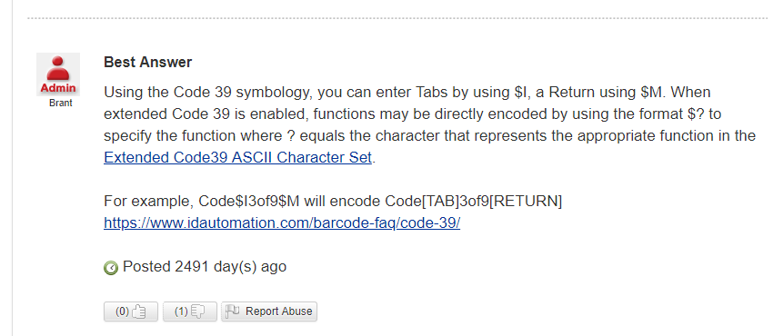

It’s been years, but iirc when we did this we embedded a TAB it into the barcode itself. I did a quick google search to make sure I wasn’t crazy (though the jury is still out on that) but looks like you can:
Dan removed it, but he is right, scanners do have a setting to do a TAB after scanning a barcode as well. Probably a better idea
