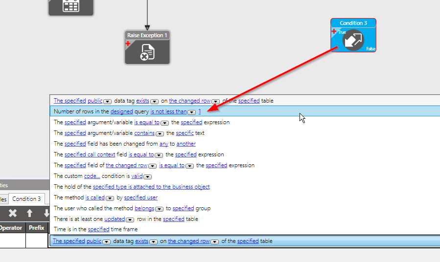

I am trying to do a customization that if a part is included in a BAQ then a native field on the quote screen will change a value. Can you please provide me some guidance how to do it i am on a cloud environment. I cant use custom code to do it through BPM.
i can use the drag and drop soft BPM to do it? ok let me look into the conditions and the options i have there thanks you so much i will let you know how i archive it
It’s a little frustrating trying to make the conditions because you can’t test it easily, (use message boxes to help you trouble shoot it) but once you get it, it works like a charm.
