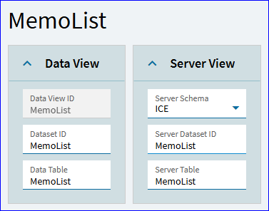

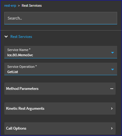

First, I created a DataView to hold the rows I request in my GetList rest call. That rest call will check to see if any memos exist for a given PONum.

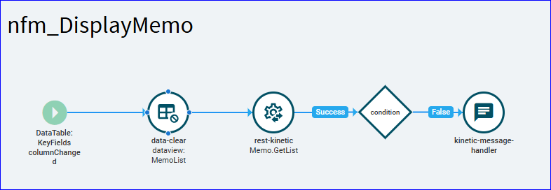

Here’s the event I set up:
I set my trigger to be DataTable > ColumnChanged > KeyFields.PONum. That way it will trigger each time the user moves to a different PO within the UI.
I added a data-clear to wipe the MemoList dataview each time there is a PONum change, then made my rest-kinetic call.

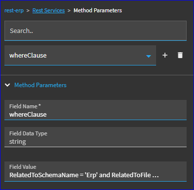

Here’s the “Field Value” you will need for the whereClause:
RelatedToSchemaName = 'Erp' and RelatedToFile = 'POHeader' and Key1 = '{POHeader.PONum}'
No Request Parameters.

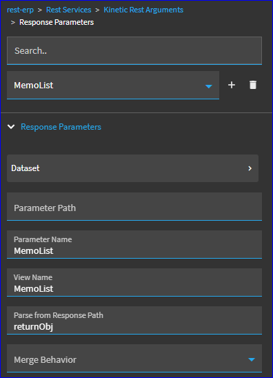

Below are the Response Parameters:

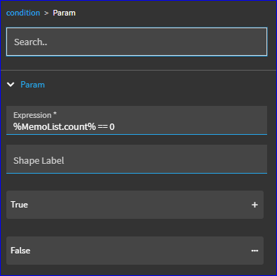

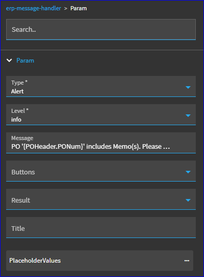

On Success of that rest call, I created a condition to see if any rows were returned (meaning that there were existing memos on the target POHeader).
So, if the row count == 0 … (true) do nothing. But on the FALSE side, I just added a message handler:

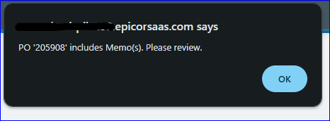

Results:
If I open a PO with no pre-existing memos… nothing happens.
If I open a PO with pre-existing memos… I get the below pop-up:

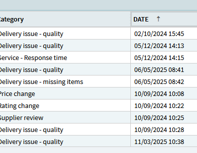

I’m just coming across this now in our upgrade. Our AR team wants to view the most recent memos for a certain customer, but the date sort doesn’t sort by date order, just numerical order of the first numbers in the date field. In our case DD/MM/YYYY. How do you find newer memos that we know are there?
This sounds like a bug for sure. Who in their right mind would want the date field sorted by the first number.
Just tested it in my supplier memo. We are on DD/MM/YYY too:
I’ve noticed this too, also in the change log on various forms. Definitely needs reported by many so they can get this fixed.
