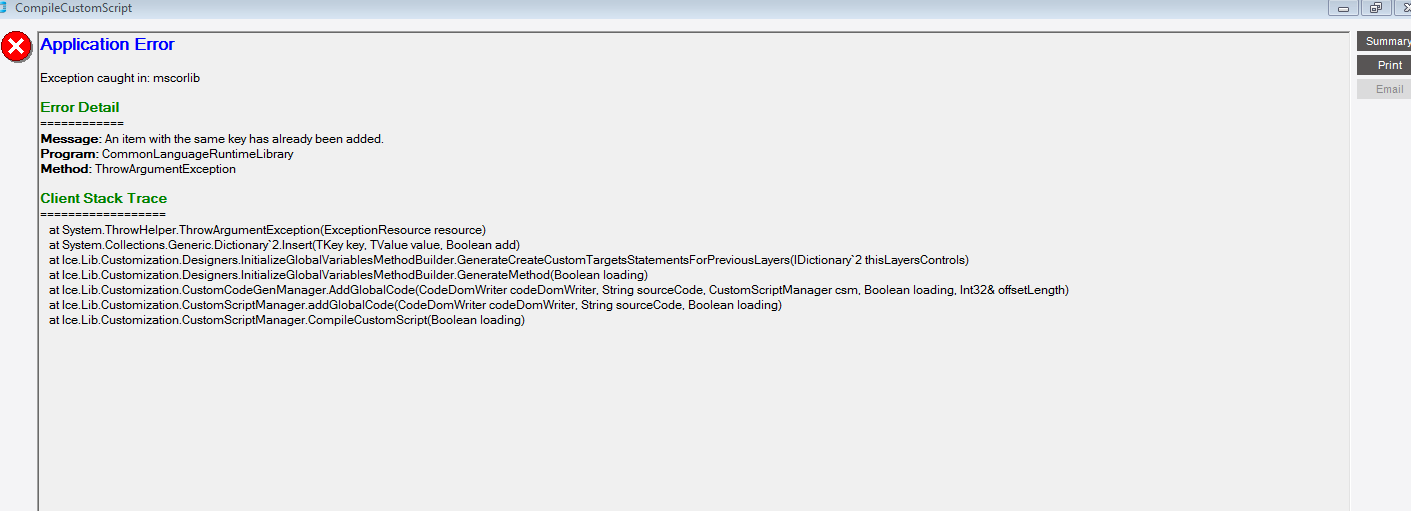

You never mentioned that exception you are getting. Has that always been occurring?
No, it is hit and miss. Do you think that is effecting it?
Absolutely it’s a strong possibility. Has it EVER occurred with all of the custom code disabled?
Yes, it has and it is happening when it is all enabled as well. The only time I don’t get that error now is when I am in customization mode.
Very early on, when I made my first post about this, I wasn’t receiving that error. I have been adding more code so I was assuming it was something I added later that is causing it. I was thinking maybe a dictionary reference?
I think it’s an issue on the dashboard itself, not the code, judging by the method thats throwing. Some control you added got jacked (the most technical term that came to mind) in the designer. It happens sometimes, ESPECIALLY with heavy UI modification.

Agreed, Custom XML is where you’ll find your issue i think, either a duplicate control name, or a duplicate guid

@Chris_Conn I also completely removed any reference to the Dictionary and relaunched not in customization mode with no exception thrown. And, it was still slow to load.
DashboardXML.txt (1.4 MB)
I dont think the issue is in your dictionaries, but in the controls dictionary (as handled in GenerateCreateCustomTargetsStatementsForPreviousLayers)
