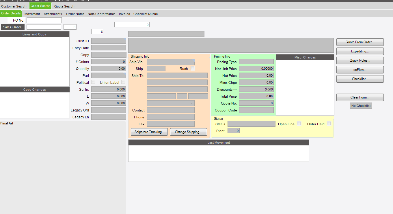

Okay, I commented everything in initialize and destroy out with the same results. Typcially a customized form will load in 15-20 seconds. I have isolated the problem to the actual customized page loading. This is the page that takes the longest. It is taking nearly 45 seconds to load before I can use it. It is pictured here:

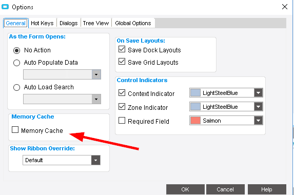

In regards to temporarily memory cache…how do I set that? Our IT director has tried it on his machine and a few other users with the same slowness in loading.

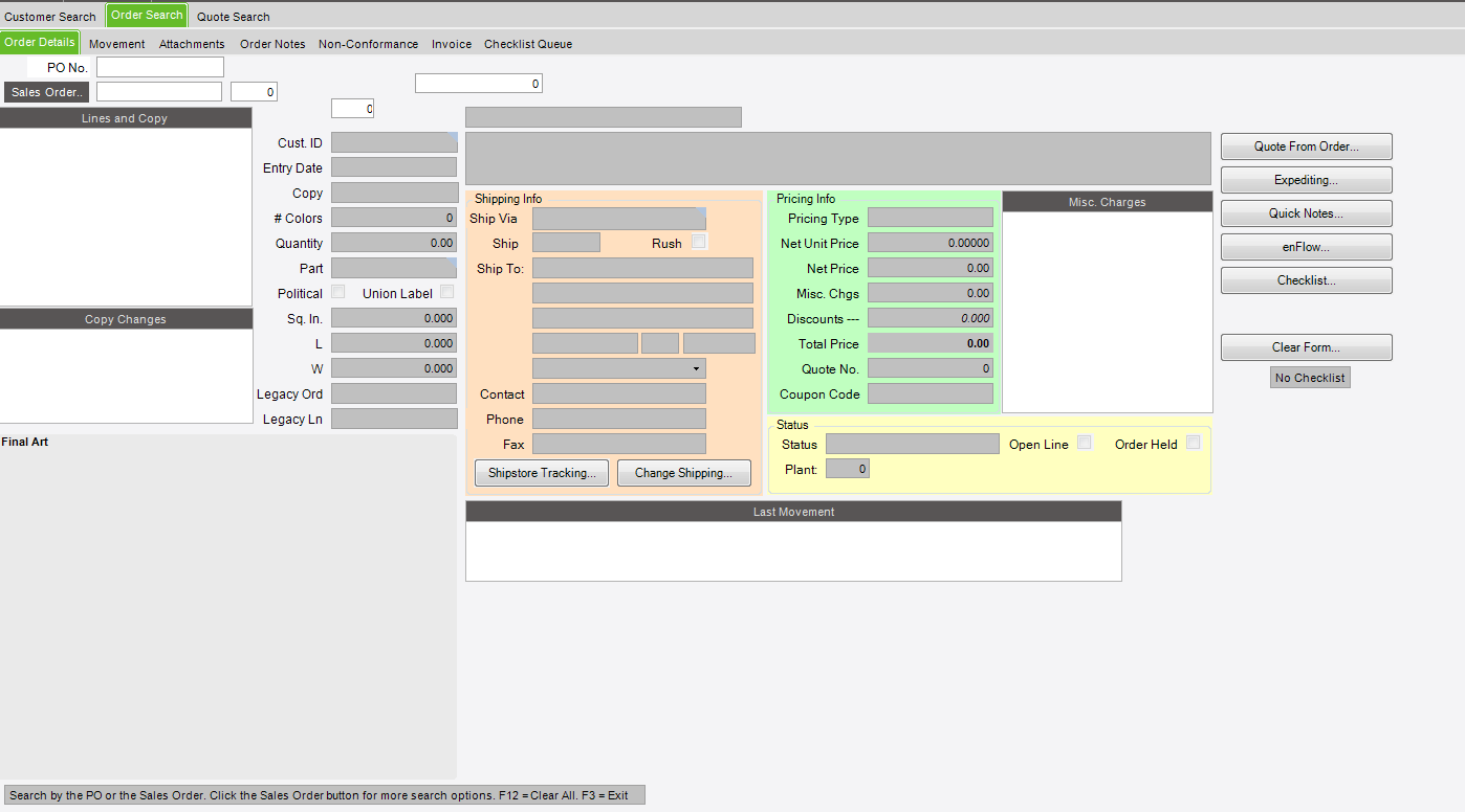

That image is messed up. Here is the one taking the longest:
Not that it should make THAT huge of a difference, but I suggest disabling your colors on those groupboxes and trying a load.

Right click form, select options, then

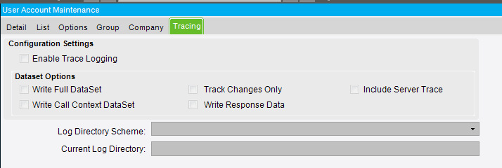

hmmmm… i am wondering if you have the tracing issue described here:
Make sure only enable and track changes only are checked, hit apply, then clear log and try again
Okay that worked.
