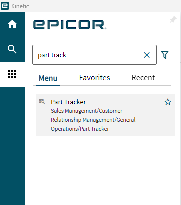

I think the latest versions will only show one menu option if they’re all set up the same.
For example, a System Admin (who has access to all menus) may have previously had (7) Part Trackers show up in their menus. Now, (IF they’re all set up the same) you’ll only see (1) Part Tracker in your menus instead of (7) of them.
But, if you apply a custom layer to (6) and not to the (7)th, you’ll see two Part Trackers in your menus because they’re set up differently.

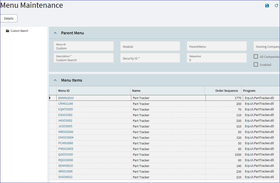

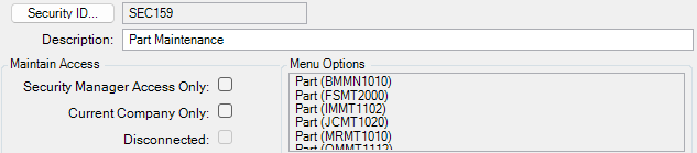

Yes, on the second tab of Menu Maintenance, you would see the Security ID and all screens that used that Security ID.
So, if you assigned a customization on the first tab, it would impact all of the screens that had the same security ID. This was all the way back in 8, but I learned it in 10. Now it seems they broke that functionality.

So, for example, there are actually (15) Part Tracker menus… here they are in Menu Maintenance:
But if I search for the menu on the homepage… I only see (1), because they’re all the same.
Previously, if I searched for Part Tracker on the homepage UI, I would see all (15) different trackers listed.

Epicor made a change to the results of the menu searches to only show one copy, not sure what version they added this to.
