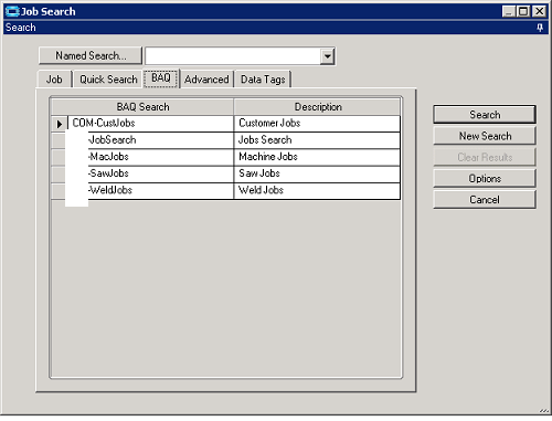

Can you use a BAQ based search instead?
That is what I usually do when I need more lookup options in a report form.

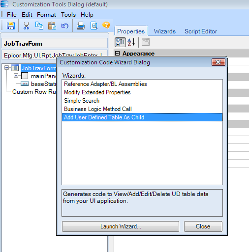

You can use a little trick here:
Use an UD table like temp table to store data of your new filter .
  1. Add an UD table as Child, using the customization wizard, this will create a new UDdataView with JobList dataview like his parent, you can use the UD table to store primary key, in this case the JobNum, and the other data of your new filter.
  2. Create a custom copy of Report Data Definition of Job Traveler Report, and add to this the same UD table.
    NOTE: Rememmber, Allways you must clean the UD table every time you start the report parameters window
