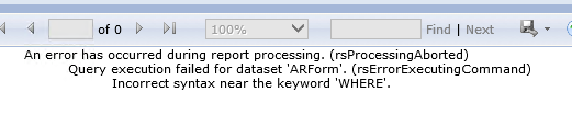

Thanks for the response! The original report runs in the system monitor, but the new report doesn’t show up at all. I grabbed the guid from the original report in the system monitor and ran the original report in SSRS with no issues, but then moved to the new report location and got the following error…
Not sure why there would be a query error when only the location is different between both forms.

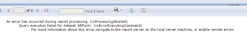

Logged into the local machine and ran the same report and got this error…
Hi
Have a look in the logs directory on your SSRS server for more information about the error.
Graeme
Hi
I now remember we had the same issue on 10.1.400.23 after copying the data source it had got the sql wrong. Two of the table aliases in the data source in SSRS had the same alias. Just tweak it in SSRS.
Graeme

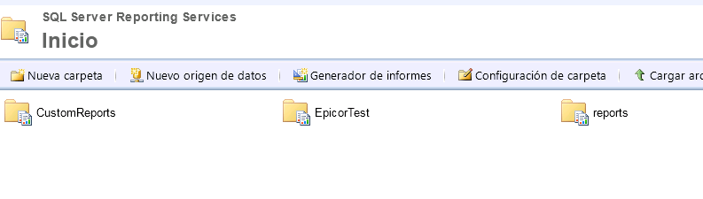

Te recomiendo que empieces por crear una carpeta de CustonReports/ Fuera de la carpeta raíz de reports/
así.
Los reportes custumizados te quedaria de esta maneras:
de esta manera te quedarían
