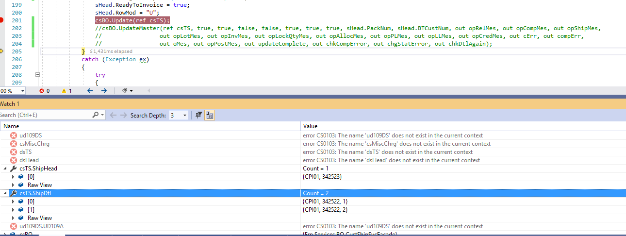

The latest issue I’ve had is that when the lines are created and I want to mark the shipment as shipped, when the update method or updatemaster is called, the BO changes the packnum of the header records to the next available pack number creating orphaned records in the ShipDtl table. Has anyone ever seen this?
As a work around, I disposed the dataset and BO and reinitialized and called GetById before the update thinking I could get a fresh dataset in memory and then set it to shipped but then I get an error that I can’t troubleshoot. See below. Any help would be appreciated.
See screenshot of packnum being changed.
