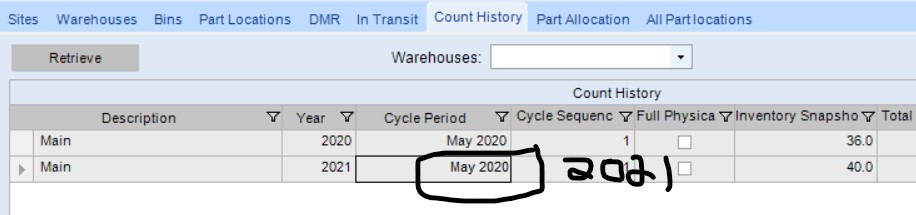

Is anyone else seeing the wrong cycle period showing up on the Part Tracker Screen? Looks like the year is wrong for parts that have been through a few cycles.
Hey all.
I noticed that today! What is that?
Maybe it’s our version?
maybe, it is just the display that is wrong. guessing its a bug
Can you do a BAQ or query on CCDtl for that part and see if the CCMonth matches?
| Title: | Part Tracker Count History displays the incorrect name for the cycle for historical data |
| Issue: | ERPS-156090 |
| Problem: | PRB0231853 |
| Fixed In: | 10.2.700.14 (possibly in patch level 600 as well) |
