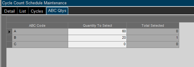

Helping set up Cycle Counts and we have run into a wall. We have set up the periods for the year, and are targeting March to start counts.
Period start is 3/1 and period end is 3/31
17 Cycle Sequences in the Period, all of which say scheduled.
When running part selection for the first Cycle Sequence, it only selects one B part, although we have asked for many more to be selected. We have ticked and unticked Exclude Parts Without Activity, getting the same results either way.
What are we missing?
2025-02-18_080105
Are ABC codes assigned to the parts you are expecting to see?
What is the lastcc date in the system? that would also drive what is to be picked.
