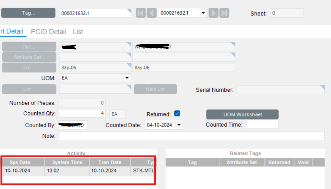

I can see activity in the count tag entry
Right. But the frozen quantity is not on this screen. You can see that in the Cycle Count Report, which will tell you what adjustments will be made when posted.

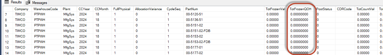

Where is the snap shot stored? I assumed it would store in ccdtl but it not there. when I run the variance report it does show a snap quantity though.
In 2022.2 it is stored in CCTag.FrozenQOH.
I have also never seen this number change but the value of the adjustment can vary based on when Tags were entered vs when material transactions happened so as was mentioned above, when you see transactions you have to kind of work out what it is going to adjust before posting.

To be clear, I am not recommending this. And sorry if I am muddying the water. What everyone else said is spot on. The frozen count is not to be touched, and Epicor does not modify it on its own. Yes, it does populate the “activity” column that can be manually overridden if needed. It also stops being populated once the tag is “returned,” I believe.
