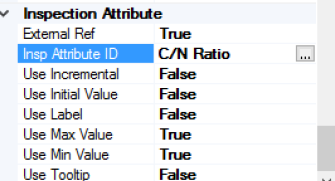

Did you tie the C/M Ratio field on the configuration form to reference the attribute?
It’s in there. You know… I’m starting to come to the realization I think you’re trying to get me to :grinning:
Why am I storing a calculation that uses other attributes to an attribute? lol, I don’t think it needs to be an attribute… it just needs to display it. That make sense? I’m thinking out loud here.
Well, if you want to be able to report on it, it needs to be an attribute in the SpecID.
What I was trying to find out was if you are using an attribute tied to a field for a SpecID that does not have that attribute in it. Try removing the reference to C/NRatio on the one that keeps erroring and see if that fixes it.
From the looks of it, I should only create attributes for items the user keys in. The C/N Ratio is not keyed in by a user. Instead, the C/N Ratio is a calculation where one keyed-in attribute is divided by the other. So really, C/N Ratio should not be an attribute. Instead, I’m going to create a control that simply displays the C/N Ratio instead. When it comes to reporting, I’ll just display the C/N Ratio by doing the same calculation.
